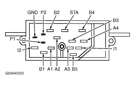

I can turn my car on but once it is on I cannot turn it off?

Sounds like the ignition switch needs to be replaced, or at least continuity checked.
STEERING COLUMN SWITCHES -1995 Ford Thunderbird LX
Page 1 of 1
IGNITION SWITCH
1.Test for continuity between specified terminals with switch in each position. See Fig. 2 . If continuity is not as specified, or is poor in any switch position, replace ignition switch.
Fig. 2: Identifying Ignition Switch Terminals (Cougar & Thunderbird) Courtesy of FORD MOTOR CO.
2.Continuity should exist between terminals B5 and I1 with switch in START and RUN positions only. Continuity should not exist for all other switch positions. 3.Continuity should exist between terminals B5 and A1 with switch in ACC position only. Continuity should not exist for any other switch position. 4.Continuity should exist between terminals A1 and B1 with switch in RUN position only. Continuity should not exist for any other switch position. 5.Continuity should exist between terminals A2 and B2 with switch in RUN position only. Continuity should not exist for any other switch position. 6.Continuity should exist between terminals A3 and B3 with switch in RUN position only. Continuity should not exist for any other switch position. 7.Continuity should exist between terminals A4 and B4 with switch in RUN position only. Continuity should not exist for any other switch position.
