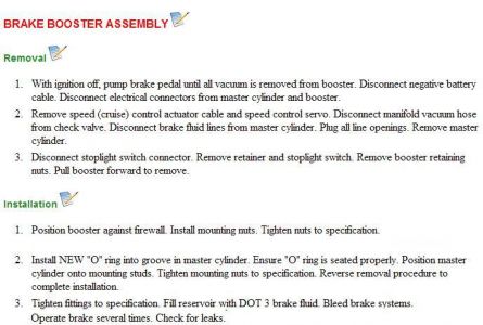

1995 Ford Thunderbird V8 Two Wheel Drive Automatic
Can you tell me what must be removed to change out the brake booster (with ABS) ? Or if this REQUIRES an engine shift?

https://images.2carpros.com/forum/automotive_pictures/261618_Noname_504.jpg
