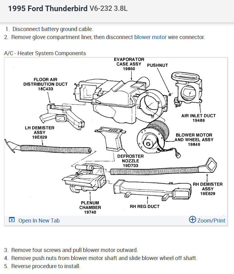

Where is the blower motor for the heater/ ac located? if possible can you post a diagram showing how to remove it

Blower motor is located behind the glove box.

Here is a diagram of the blower motor and how to change it out. Check out the images (below). Let us know if you need anything else.
