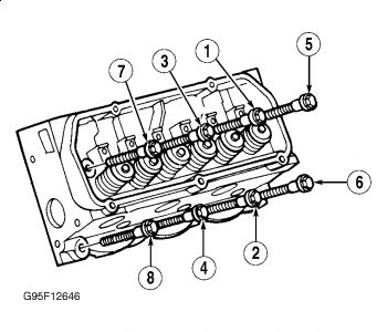

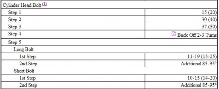

Is there a simpler procedure to torque 3.8 ltr. V-6 heads in a 94 Thunderbird than what Chiltons manual instructs. Using this method I can't get a true seal of the heads and end up with water in the #2 cylinder and car running hot with no compression.
Sep 20, 2009 at 10:27 AM
BLUELIGHTNIN6
  • 16,542 POSTS
this is the correct torque and sequence specs..
https://images.2carpros.com/forum/automotive_pictures/261618_Noname_1063.jpg
https://images.2carpros.com/forum/automotive_pictures/261618_Noname2_305.jpg

is there a bigger picture and also i dont understand the numbers on the side of the steps?
Nov 27, 2009 at 9:51 AM
BLUELIGHTNIN6
  • 16,542 POSTS
bigger picture of what..?
which number? the numbers to the right is in foot pounds then the paranthesis is in Nm measurements. so its like 8 foot pounds OR ? Nm ...whichever your wrench has on it.
