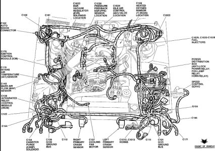

1994 ford thunderbird.Where is the fuel pump relay.
Looked left rear of trunk.Only thing there is the inertia switch.
Jul 29, 2010 at 3:08 AM
  • 75,992 POSTS
Fuel pump relay is integrated within the Integrated Relay Control Module-see diagram below:
https://images.2carpros.com/forum/automotive_pictures/12900_fpr_22.jpg
The Integrated Relay Control Module is located at the RH front of engine compartment, mounted to upper radiator support. https://www.2carpros.com/kpages/auto_repair_manuals_alldata.htm
