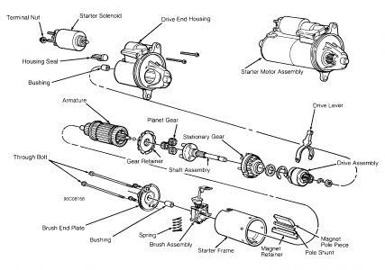

Both battery and starter have been recently replaced, car just clicks when i try to start it. do you have any diagrams of the starter silenoid or do you know why car only clicks.

check the battery for full charge ? check the connections on starter for corrosion and tightness TAP the starter motor a few times with a hammer it may be jammed
https://images.2carpros.com/forum/automotive_pictures/266999_starter_2.jpg
BASIC STARTER TROUBLE SHOOTING CHART CONDITION & POSSIBLE CAUSECORRECTION Starter Fails to Operate Dead battery or bad connections between starter and battery....Check battery charge and all wires and connections to starter Ignition switch faulty or misadjusted....Adjust or replace ignition switch Open circuit between starter switch ignition terminal on starter relay.....Check and repair wires and connections as necessary Starter relay or starter defective....See Testing in STARTER article Open solenoid pull-in wire.....Testing in STARTER article Starter Does Not Operate and Headlights Dim.... Weak battery or dead cellCharge or replace battery as necessary Loose or corroded battery connections....Check that battery connections are clean and tight Internal ground in starter windings....See Testing in STARTER article Grounded starter fields....See Testing in STARTERS Armature rubbing on pole...See STARTER article shoes
