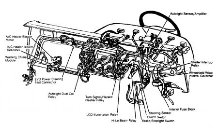

where do i look to find the electronic flasher?
Feb 19, 2009 at 4:29 PM
DAVE H
  • 13,384 POSTS
Turn Signal/Hazard Flasher Relay....Behind dash, right of steering column. See Fig. 3 Combination turn signal/hazard flasher is located to RH side of steering column opening reinforcement, mounted on a bracket.
