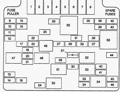

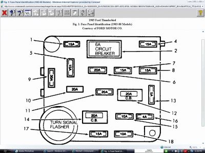

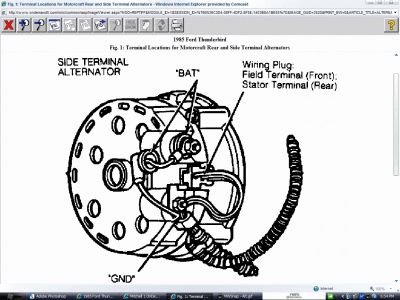

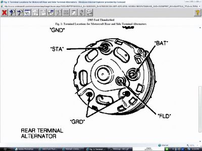

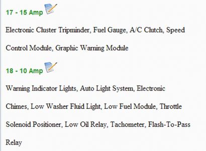

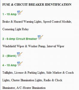

My t-bird is turbo - 4 banger 5 spd. the alternator stopped charging the battery. The prior owner wired the car for his stereo & in doing this he altered the normal wiring harness. I found the ground wire for the alternator 'hot' all the time - as it started to melt when i tried to run it to ground.
I have grounded it successfully - however - my windshield wipers are on non-stop high.

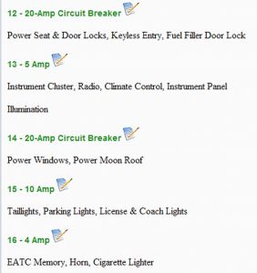

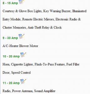

I do not have the fuse box layout for this car & am unsure which fuse to pull for the wipers. For obvious reasons & cannot drive with my wipers on nonstop high!
I must fix myself & would be grateful for a fuse box diagram layout - or suggestion - i have never replaced a wiring harness or would have by now. my car has all stock - turbo is great - but demolished in the electrical department.

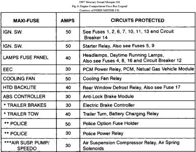

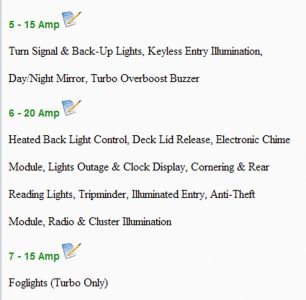

What color was that ground wire that melts? Anyways here's the fusebox layout!
https://images.2carpros.com/forum/automotive_pictures/62217_Fuses_2.jpg
https://images.2carpros.com/forum/automotive_pictures/62217_Fuses1_1.jpg
https://images.2carpros.com/forum/automotive_pictures/62217_Fuses2_1.jpg
https://images.2carpros.com/forum/automotive_pictures/62217_Fuses3_1.jpg
https://images.2carpros.com/forum/automotive_pictures/62217_Fuses4_1.jpg
https://images.2carpros.com/forum/automotive_pictures/62217_Fuses5_1.jpg

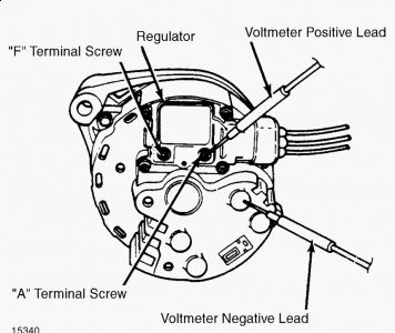

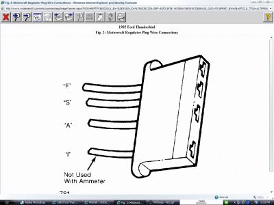

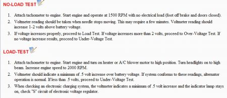

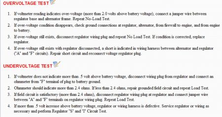

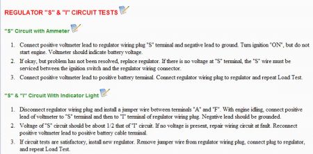

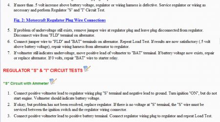

AS a bonus here's the way to test the alternator, and regulator...
https://images.2carpros.com/forum/automotive_pictures/62217_Alt1_1.jpg
https://images.2carpros.com/forum/automotive_pictures/62217_Alt2_1.jpg
https://images.2carpros.com/forum/automotive_pictures/62217_Alt3_1.jpg
https://images.2carpros.com/forum/automotive_pictures/62217_Alt_1.jpg
https://images.2carpros.com/forum/automotive_pictures/62217_Alt_tests1_1.jpg
https://images.2carpros.com/forum/automotive_pictures/62217_Alt_tests2_1.jpg
https://images.2carpros.com/forum/automotive_pictures/62217_Alt_tests3_1.jpg
https://images.2carpros.com/forum/automotive_pictures/62217_Alt_tests4_1.jpg
