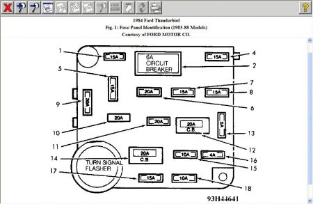

i just wanted to know what the fuse color and fuse size number for the blower motor and what side is it on in the fuse area.

check fuse no.9 30amp fuse Turn key On and heater control switch check for power at the blower connector orange wire-
https://images.2carpros.com/forum/automotive_pictures/12900_fuse_panel_2.jpg
