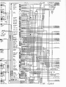

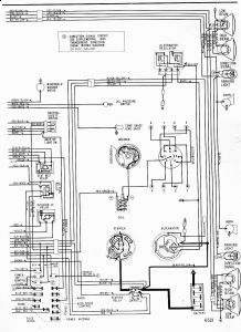

here is wiring diagram for the thunderbird. in my 62 ford I found that the fuse box was giving me a peoblem. Follow the current ftom the signal light fuses to the steering colimn. Most times the connections by the steering wheel could have a bad connection

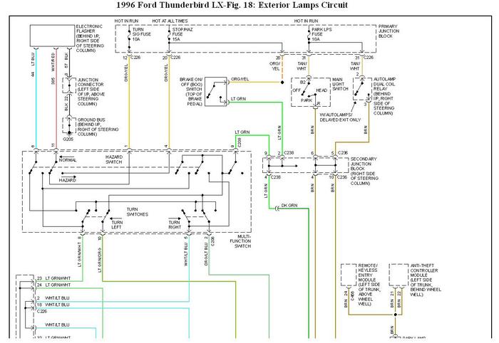

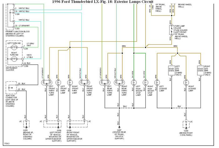

1996 Ford Thunderbird. Turn signals do not work. Even the turn signal dash lights won't flash. Have changed the switch and checked the fuses but they still do not work. Any ideas?
Apr 18, 2019 at 10:59 AM (Merged)
KHLOW2008
  • 41,812 POSTS
Are the hazards working?
When turn signals don't indicate, there is a power supply problem. It could be a bad switch, broken wires or unplugged socket connections.
Apr 18, 2019 at 11:00 AM (Merged)
BULLDOG663
  • 8 POSTS
Turn signals both outside and on dash do not work and hazards do not work. All brake lights work and headlights both high and low beams work. The brake lights didn't work until we saw a trick online to spray WD40 in hazard switch and wiggle it and the brake lights all started working but still no turn signals or flashers. We then replaced the turn signal multi switch and same problems. So we figure it is specific to the turn signal/hazard but don't know where to start?
KHLOW2008
  • 41,812 POSTS
Here are the schematics of the lighting diagrams.
I would suggest starting with the electronic flasher.
BULLDOG663
  • 8 POSTS
This looks really confusing. Any advice or pointers on how to start/do?
CHRISTYRACE88
Both turn signals are NOT working, but the hazard signal DOES WORK. I have replaced the fuse for turn signal, but it did not correct the problem. My instinct is that the FLASHER unit may need to be replaced, but since the hazard signal works, I am not certain. From what I have read, the Flasher unit in the '96 Thunderbird is a mult-function unit which controls both the turn signals and hazards. So....if hazards are working, it doesn't make sense that the unit is failing. What do you think? Am I correct about the "multi-function" of the flasher? Is it possible to have that the flasher could work for the hazards, but not the turn signals??? HELP ME TROUBLE SHOOT!! PLEASE!
KHLOW2008
  • 41,812 POSTS
With a test lamp or DVOM, check for battery voltage at the Orange/Yellow wires.
When hazard lights are turned on, check for battery voltage at the White/Red wire. If voltage is available and not coming out of the electronic flasher Light blue wire, the electronic flasher unit is faulty or has insufficient ground.

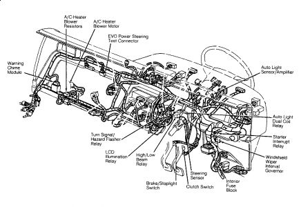

TSKRTICH
  • 9 POSTS
Electrical problem
1991 Ford Thunderbird 6 cyl Two Wheel Drive Automatic
They don't work. I've had relays go out on other cars before but the difference is that you can operate the light manually, meaning, turn them on and off repeatedly to make them blink. This vehicle I have nothing.
Now is this just a relay or is it deeper, requiring a little digging into the electrical? First were is the relay located at?
BLUELIGHTNIN6
  • 16,542 POSTS
Hello and thanks for the donation! Your vehicle's turn signal / hazard flasher relay is located behind the dash, right of the steering column. .
https://images.2carpros.com/forum/automotive_pictures/261618_Graphic_165.jpg
So you're saying that the turn signal lamps are not lighting up at all correct? How about the hazard switch, does it operate the signal lamps properly?

TSKRTICH
  • 9 POSTS
My hazards work but my turn signal dont. No illumination or "clicking" when opperating the signals.
BLUELIGHTNIN6
  • 16,542 POSTS
Okay, since the hazards do work this eliminates a faulty relay as both the hazards and turn signals use the same relay to function. This leads to either faulty wiring at the multifunction (turn signal) switch or a faulty switch itself.
