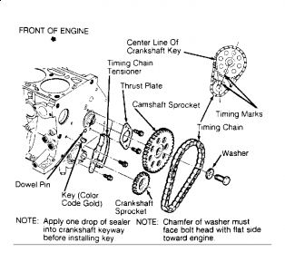

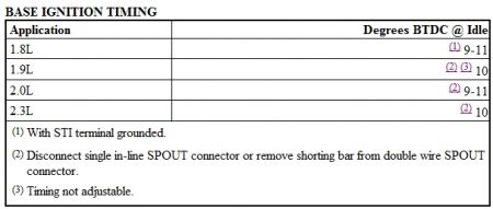

What is the timing specs for a 94 ford tempo. Not the firing order, the position of 0 when cylinder 1 fires.
