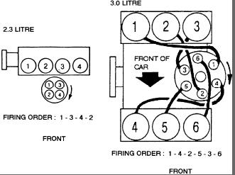

I am looking for the spark plug firing order for my 1994 Ford Tempo GL. I just changed my distributor cap and rotor, and I am almost certain I reconnected the spark plugs wrong since the car now sputters hard and will barely accelerate. Any thoughts here?

https://images.2carpros.com/forum/automotive_pictures/170934_ford_tempo_1.jpg
