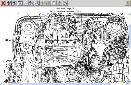

I am having trouble getting my electric fan to run on my 2.3l ford tempo. I know the fan works because i took it out and had it checked and running. the tempature indicator inside does not move anymore and when i install the fan motor it is not getting juice i was wondering where there might be a relay or fuse at to fix this and what do i need to get the gauge to work again

Test the coolant temperature sensor and if it has a engine temperature gauge switch check that too, also the fan relay- Coolant temperature sending unit at item no.30
https://images.2carpros.com/forum/automotive_pictures/12900_cts_16.jpg
