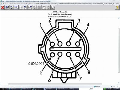

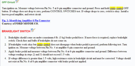

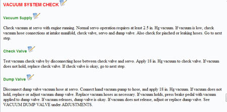

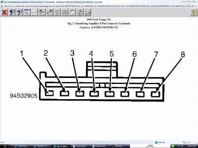

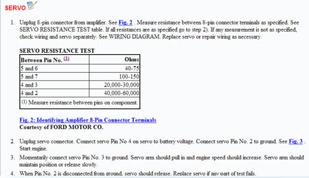

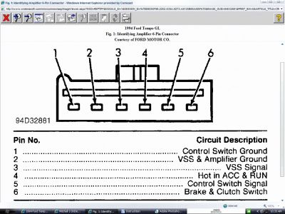

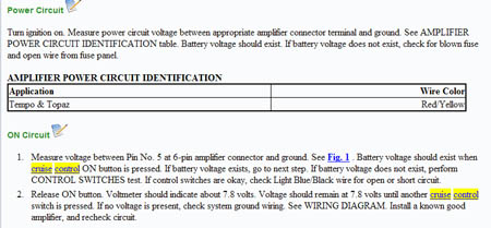

i just bought the car, cruise control doesn't work, no visual of cruise on the dash elecronic panel when cruise switch engaged. i replaced the speed sensor, that didn't work. any other suggestions, might it be a vaccuum hose, checked the fuse it was not blown. thank you...
Mar 9, 2008 at 1:38 AM
MERLIN2021
  • 17,250 POSTS

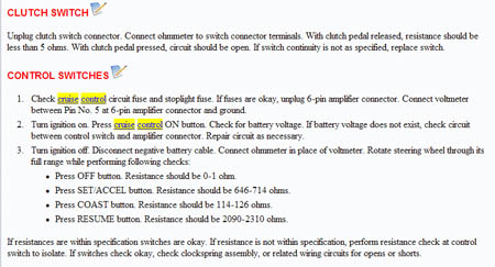

Here are some tests for you to run!
https://images.2carpros.com/forum/automotive_pictures/62217_Cruise1_1.jpg
https://images.2carpros.com/forum/automotive_pictures/62217_Cruise2_1.jpg
https://images.2carpros.com/forum/automotive_pictures/62217_Cruise3_1.jpg
https://images.2carpros.com/forum/automotive_pictures/62217_Cruise4_1.jpg
https://images.2carpros.com/forum/automotive_pictures/62217_Cruise5_1.jpg
https://images.2carpros.com/forum/automotive_pictures/62217_Cruise6_1.jpg
https://images.2carpros.com/forum/automotive_pictures/62217_Cruise7_1.jpg
https://images.2carpros.com/forum/automotive_pictures/62217_Cruise8_1.jpg
