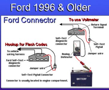

You have a rack and pinion steering system, there is no idler arm...if the check enging light comes on, have the codes read, This is where to start. If the tires wobble, jack both off the ground, place your hands at 3 and 9 oclock, and shake, it's either going to be a ball joint or an inner or outer tie rod end.[img]https://www.2carpros.com/forum/automotive_pictures/62217_Test_Connector_Pre96_12.jpg[/imCount the flashes, a 22 will flash as 2 flashes then a short pause, then 2 flashes, if more than one code is stored, the pause will be longer. The codes will display three times and end with 11 or 111. Write them down and post here.g]
https://www.2carpros.com/forum/automotive_pictures/62217_Test_Connector_Pre96_13.jpg
