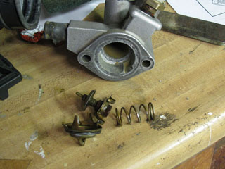

Can anyone tell me where their temperature gauge sits when the car has warmed up and idling. On this car the temperature gauge points to the 'A" on the word NORMAL when the temperature reading is 195 degrees from the ECT sensor.
The fan will come on around 213 degrees and cools the engine down to around 209 then turns off. I would think the engine would cool down to below 195, but this is not the case.
I thinking that the thermostat my not be opening all the way.

do you have an infrared temp reader? they sell them at harbor freight pretty cheap. you can check temps all over engine and hoses and radiator. all the tempos i've owned show about r or m lettter when warmed up. and the fans come on much sooner according to gauge temp. berfore red is reached. you could have a blocked dirty radiator/fins?you can try washing with waterhose aimed from front. as long as water bottle dont bubble/hiss/steam you are probably ok. do you have air cond and use it? this can account for higher temps.
Oct 9, 2009 at 11:17 PM
JSMERDEL
  • 9 POSTS
I have an Infra Red gun and the temp is ok at the thermostat housing and upper radiator hose. The overflow bottle doesn't bubble, or hiss. I did remove the radiator cap and the temperature of the fluid was only around 100 degrees. I'm thinking the thermostat is not opening all the way. I won't have time to get back to it until weekend after next, but I think I'm going to remove the thermostat and see if that fixes it.
Oct 9, 2009 at 11:38 PM
JSMERDEL
  • 9 POSTS
I had some time today, so I decided to remove the thermostat and see if that cured the heating issue. I did not have to look any further. The thermostat was in two pieces. I picked up a new thermostat at Kragen and a gasket at Autozone and put it back together. The radiator fluid, upper and lower hose are now all at the same temperature. The temp gauge now reads between the R and M in the work NORMAL. Driving it around with normal stops, it will stay closer to te 'R'.

Here is a picture of the bad Thermostat
https://images.2carpros.com/forum/automotive_pictures/414257_tempoPic2sm_2.jpg
Oct 13, 2009 at 3:42 PM
FIXITMR
  • 9,990 POSTS
cant say i've ever come across 1 like that. maybe the car went without antifreeze for a time? of course if it's original then time is certainly a factor for corrosive effects.
