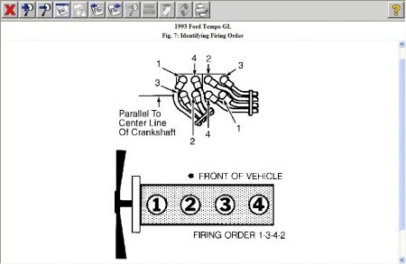

1993 Ford Tempo firing order
1993 FORD TEMPO
JOHNBLAIR2000
1993 Ford Tempo 4 cyl Two Wheel Drive Manual
I would like to know the firing order for my car. I drove it about 12 milles and at the first one to two miles it started to smell like it was burning and also it didn't pick up the speed and it was running terrible. I have just changed out the rotar and distributer cap. I was just wondering what the pattern was to make sure that I have it on the right way? My wife needs the car and can't drive it that way. But then what else would it make it not drive right?
Oct 1, 2008 at 9:36 AM
  • 75,992 POSTS
Check the drive belts and look fluid leaks
https://images.2carpros.com/forum/automotive_pictures/12900_fo_6.jpg
Oct 1, 2008 at 10:49 AM
