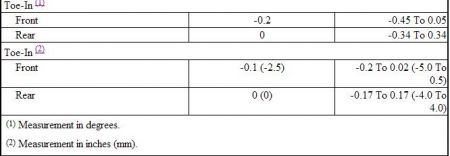

MHPAUTOS
  • 31,937 POSTS
This car is set with Toe in, see specs from Mitchell 1.
https://images.2carpros.com/forum/automotive_pictures/61395_Noname_96.jpg
Mark (mhpautos)
Dec 13, 2009 at 10:40 PM
FIXITMR
  • 9,990 POSTS
hhmmmmm......guess i'll try that setting and see how it works. 1/4" narrower in front! probably wont be able to notice the diff though? with the way roads are these days and the wear and tear on other front end parts and the daily treck to work and back,your lucky to get through a year without something effecting tire wear!
