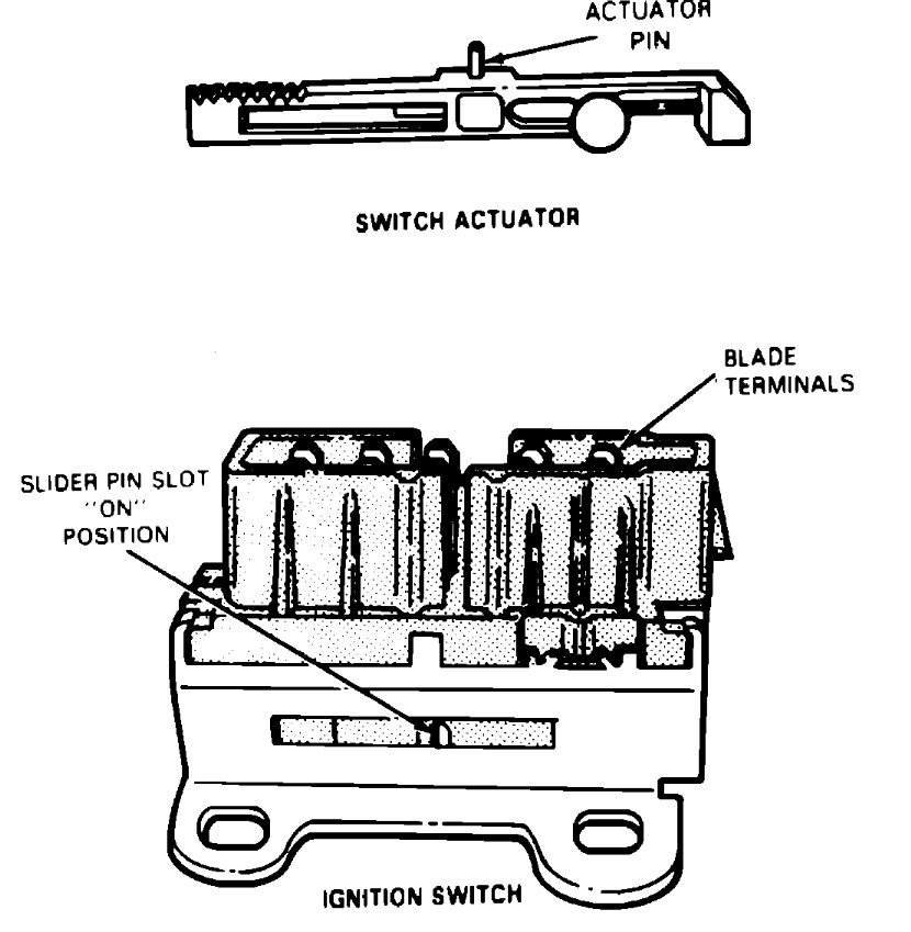

on my tempo sometimes the heater blower motor turn signals and rear defroster just won't work other days its fine what could be wrong

Hi there,
Check for a loose fuse holder or a bad connection at the rear of the fuse box, if that is okay the ignition switch sounds like it is going out which is common. Here is the location so you can swap it out.
MODELS LESS PASSIVE RESTRAINT SYSTEM
1. Disconnect battery ground cable, then remove five steering column shroud attaching screws.
2. Remove two bolts and two nuts attaching steering column to column bracket, then lower steering column assembly to seat and remove column shrouds.
3. Disconnect ignition switch wire connector, then rotate ignition switch lock cylinder to the Run position.
4. Remove the two shear bolts using an easy out.
5. Detach ignition switch from actuator pin, then remove switch.
6. Check to ensure that ignition switch actuator pin slot and ignition switch lock cylinder are in the Run position. Replacement ignition switches are set in the Run position. The Run position on the ignition switch lock cylinder is located approximately 90° from the lock position.
7. Position ignition switch on actuator pin. It may be necessary to move switch slightly to align switch to column mounting bolt holes, Fig. 1.
8. Install and tighten shear bolts until heads break off.
9. Connect wire connector to ignition switch, then connect battery ground cable and check ignition switch for proper operation.
10. Position upper shroud on column, then raise steering column and install column mounting bracket to instrument panel attaching bolts. Torque bolts to 15 to 25 ft. lbs.
11. Position lower shroud on column and install attaching bolts.

Check out the images (below). Let us know if you need anything else.
