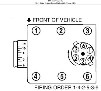

COULD YOU TELL ME THE FIREING
ORDER OF THE CAR?

But of course........
