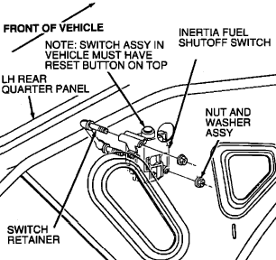

1991 Ford Tempo fuel shut off
BURGIN1
1991 Ford Tempo 4 cyl Two Wheel Drive
i was wondering if you could tell me where the fuel shut off switch is for a 1991 ford tempo? we tore the trunk apart and could not find it
Nov 12, 2008 at 9:34 AM
ZACKMAN
  • 4,202 POSTS
https://images.2carpros.com/forum/automotive_pictures/55316_Tempo_Shut_Off_Switch_1.gif
Nov 13, 2008 at 12:58 PM
