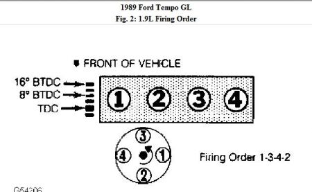

1989 Ford Tempo spark plug firing order
1989 FORD TEMPO
GCAUDILL7
Engine Mechanical problem
1989 Ford Tempo 4 cyl Two Wheel Drive Automatic
I no longer have the manual for the car and the spark plug wires were removed. I need to figure out the firing order.

https://images.2carpros.com/forum/automotive_pictures/30961_tempofir_1.jpg

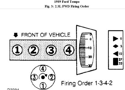

https://images.2carpros.com/forum/automotive_pictures/139033_coil_3.jpg
