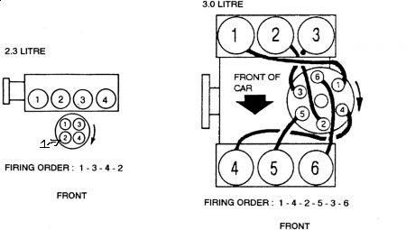

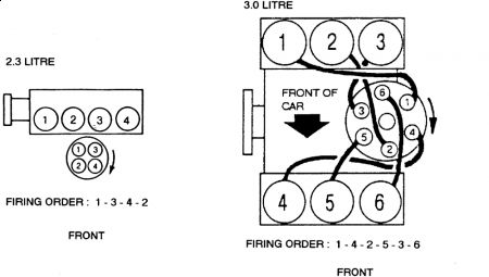

I took the spark plug wires off the distributor cap on my '85 ford tempo, and for got where the wires went on the distributor cap! I have Googled it and I cant find any info on it. Does anyone know where they go? Thanks for you help!

https://www.2carpros.com/forum/automotive_pictures/261618_0900c1528005d56e_1.jpg

THANK YOU! I will post here more often for my car problems.

Ok I hooked it up like the diagram shows and it doesnt start! ON the distributor cap there is a 1 where the spark plug for the 2nd cylinder spark plug wire goes. should I try swaping #1 and #2?
https://www.2carpros.com/forum/automotive_pictures/340860_261618_0900c1528005d56e_1_1.jpg
edit: What if I tried putting #1 where the 1 is on the cap, then go in order putting 3,4,2 after it.

Firing order in diagram should be correct unless your vehicle is not the stock equipment. What is the 8th digit of your VIN just so I can make sure this is the correct firing order?

Why not try starting the wiring sequence as the actual cap suggests?Worse could happen is a little backfire. If the distributor has been removed before and not put back in the same position or the diagram is not totally accurate as to distributor position but approximate then there ya go!Dont mix the sequence by just switching 1 or 2 wires. Trace each wire to it's designated cylinder per the diagram.

Sorry for the late reply. I hooked it up like the distributor says and it works! Thanks for your help.
