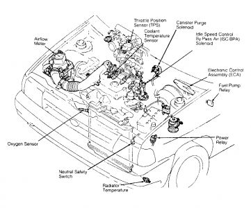

  • 75,992 POSTS

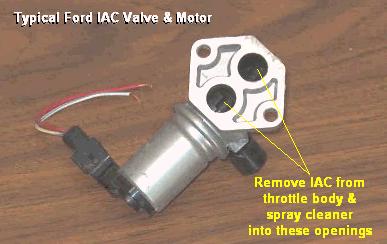

The IACV looks like this its on the throttle body
https://images.2carpros.com/forum/automotive_pictures/12900_iac_valve_ford_13.jpg
Same goes to the TPS at the throttle body, for the MAF sensor -check the airflow meter For the IACV change it to : idle speed control bypass valve solenoid.
https://images.2carpros.com/forum/automotive_pictures/12900_telstar_1.jpg
