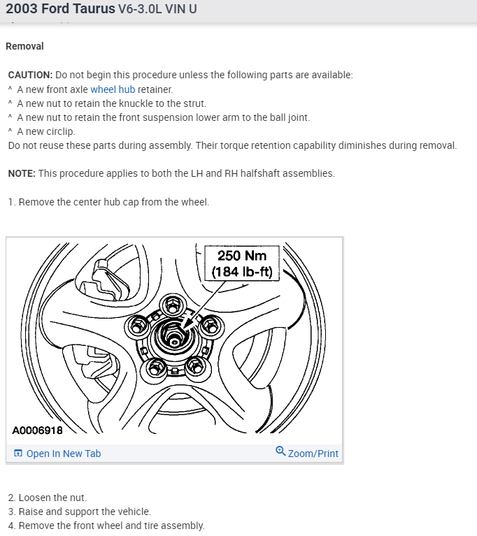

I need to replace the cv joints and want to know if there is anything special?
2003 FORD TAURUS
CLISHMAN67

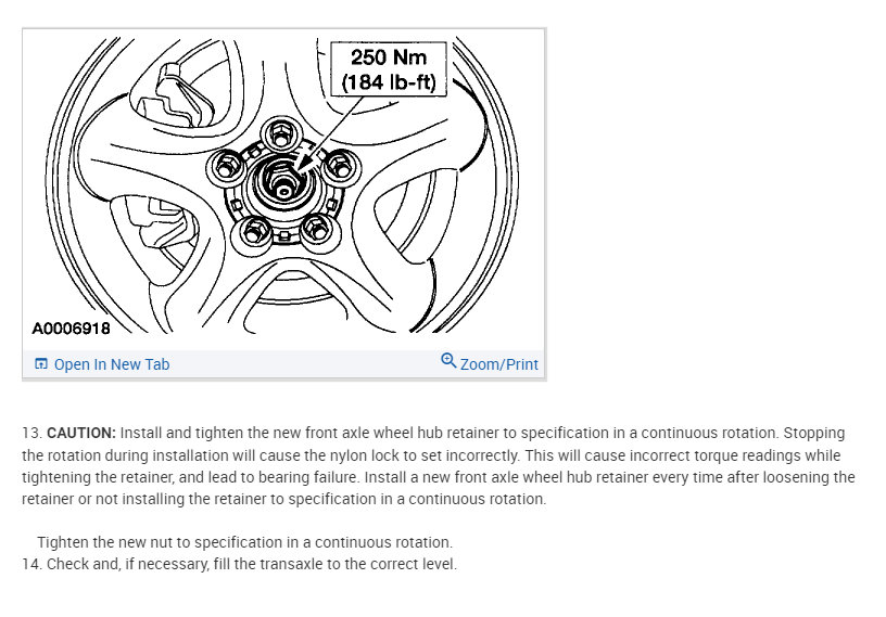

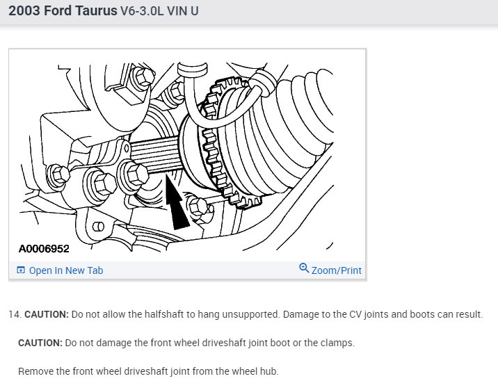

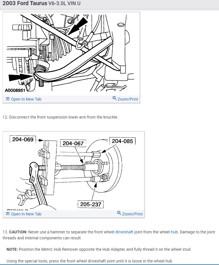

I have a 2003 Ford Taurus with 89231 miles. I need to replace the cv joints and want to know if there is anything special I should be aware of. I have a generic instruction, but need to know if there are special torq or special tools or things that I need to watch out for with a Taurus
Thank you!

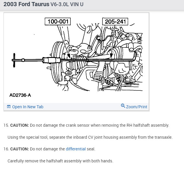

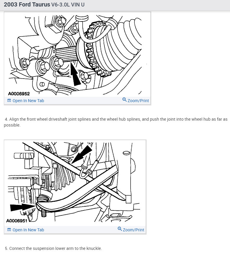

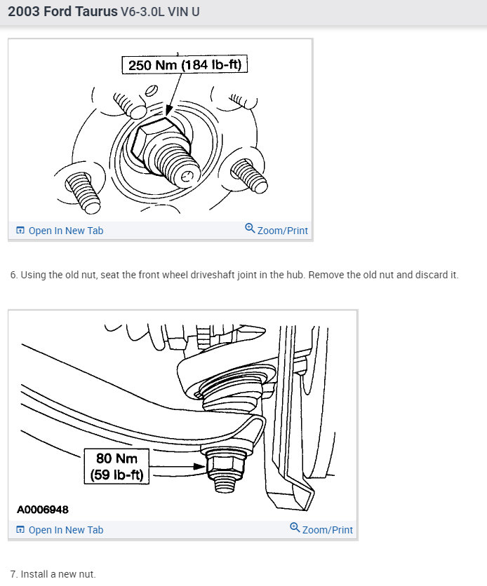

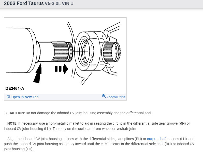

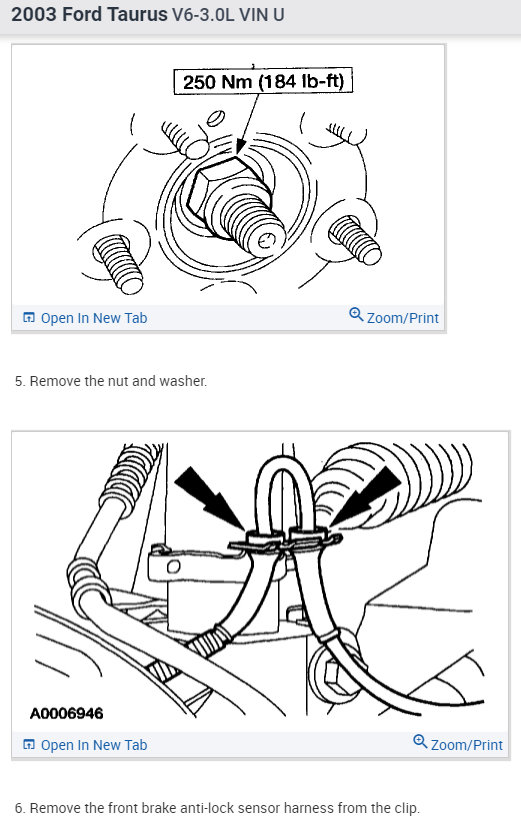

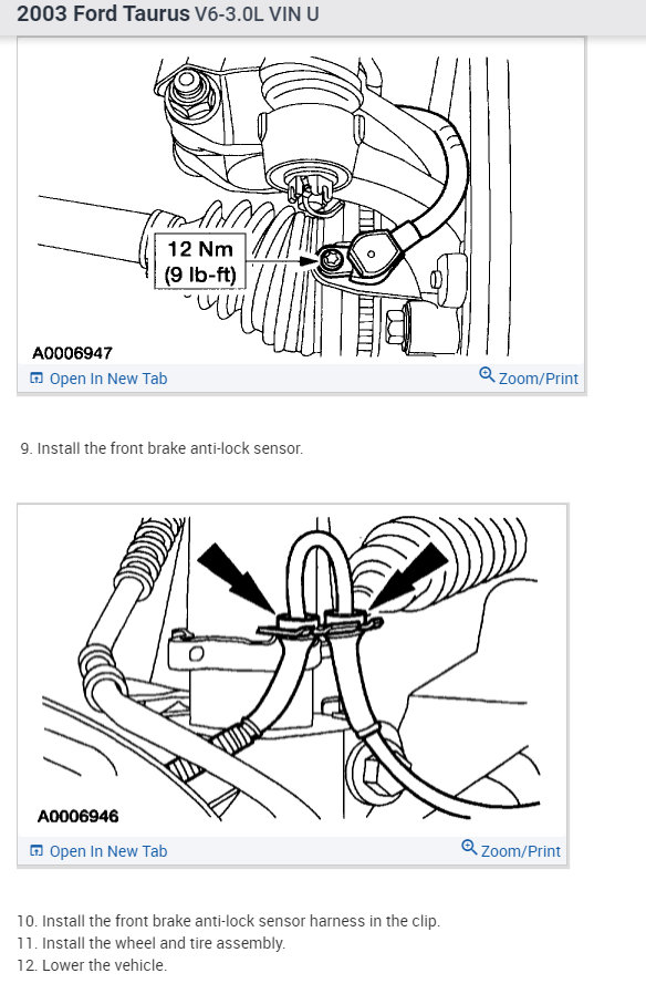

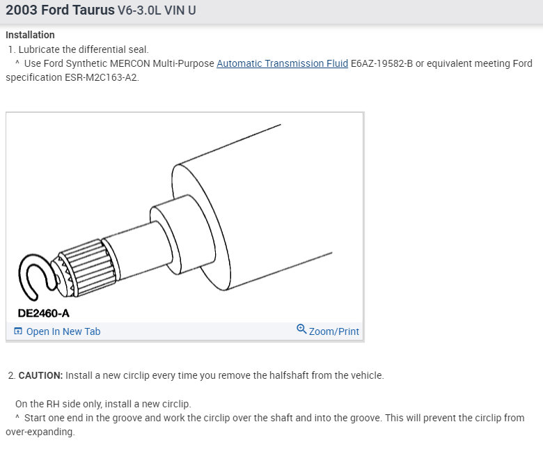

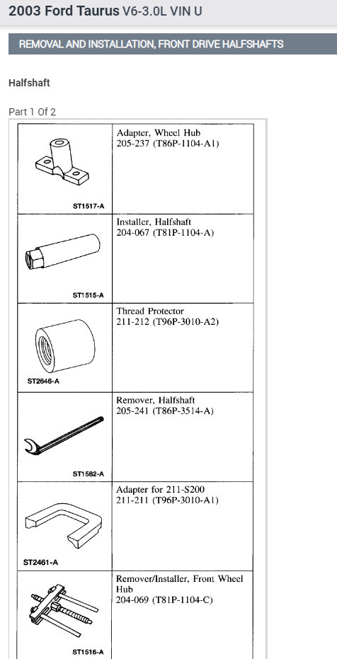

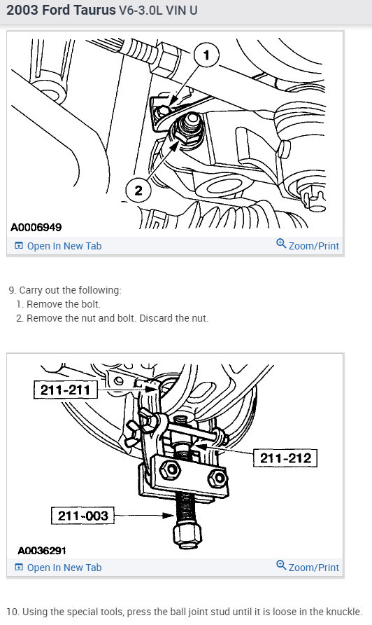

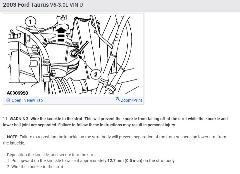

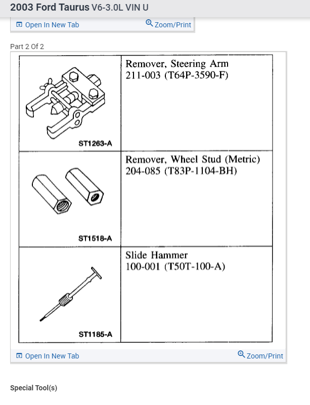

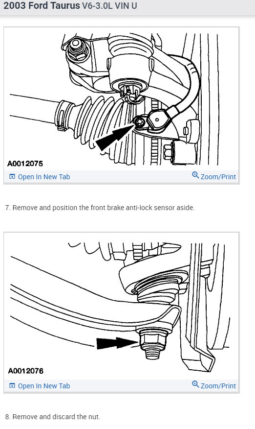

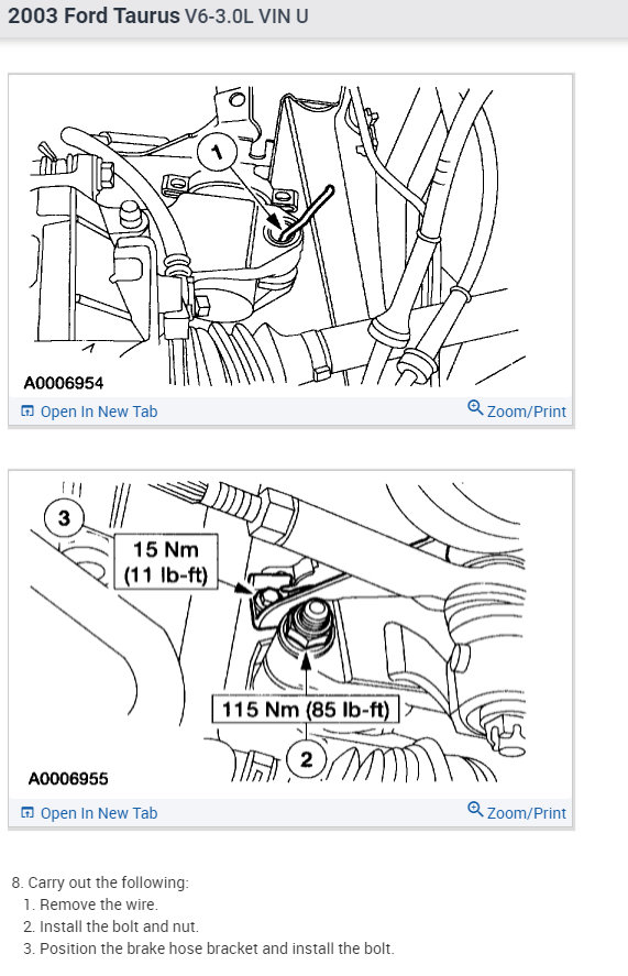

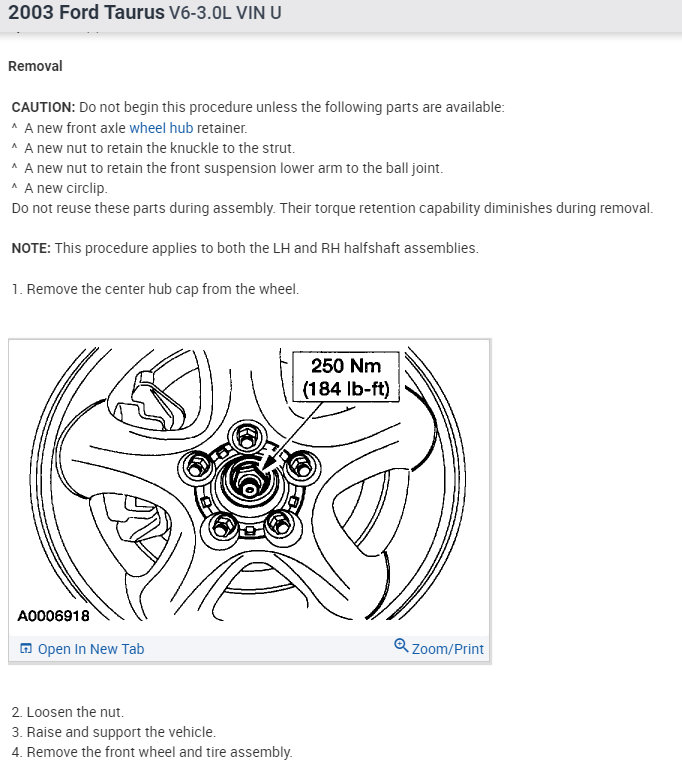

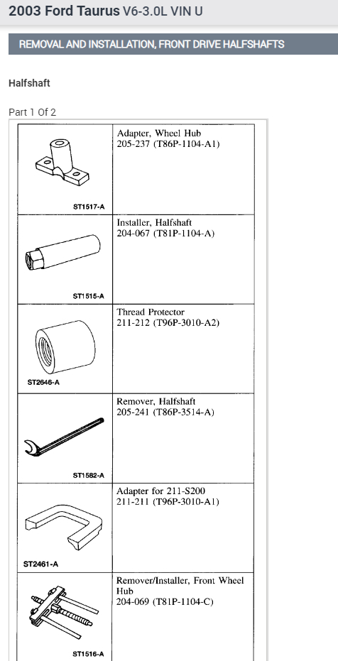

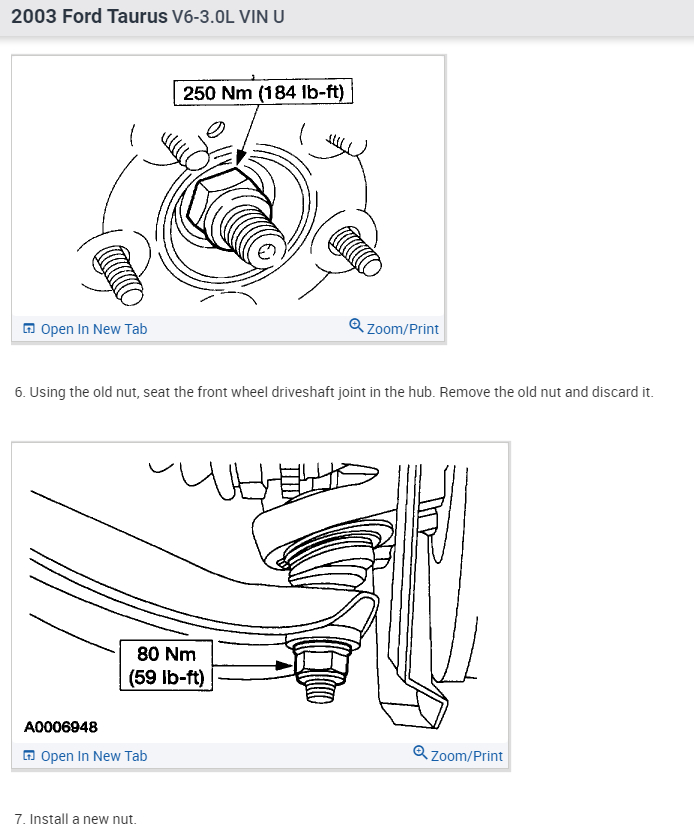

There are a few specials tools that need to be used to finish this job.
Primarily you will need a hub puller and a slide hammer tool. Most of these are typically available at your local auto parts store that can be rented to use.
Here is a helpful guide on CV axle replacement:
https://www.2carpros.com/articles/replace-cv-axle
I have attached the replacement instructions as well as the tools required and all the torque specifications below.
