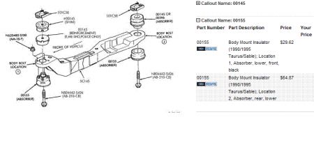

how do you replace the motor mounts(front) on a 1991 ford taurus wagon? is there any way to see a diagram on line?
Oct 31, 2018 at 6:34 PM (Merged)
JALOPYPAPA
  • 467 POSTS
There are two mounts, fore and aft in the passenger side of the engine compartment. Remove nuts from their studs in the subframe, the front one though an oblong hole and the rear one in the corner of a squarish bracket. Remove the right wheel and perhaps the fender well liner and remove the two forward mount through bolts from the A/C compressor bracket. The two rear mount through bolts are just above the axle.
On the driver's side, there's one mount for the engine and transaxle, accessible through the left wheel well. Two bolts secure the mount to the frame and one through the round rubber mount to a bracket on the engine/transaxle.

BMRFIXIT
  • 19,053 POSTS
Is this what you are looking for?
https://images.2carpros.com/forum/automotive_pictures/99387_1_38.jpg
