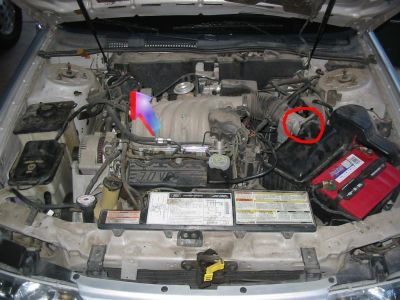

95 Tarus 3.0L Sedan with 86,000 miles:
Musty, moldy smell coming from the vents. Even when they are off the smell is quite pungent. According to http://www.2carpros.com/topics/ac1.htm
"Try mixing 20% bleach and water in a spray bottle and spaying it into the intake of the heater system while on high speed fan this should kill the smell. Then let air out for 4 hours in dry warm place."
I am not certain where the heater intake is. I have included a photo with a red circle around where I think it is, just above the air filter housing.
It also is constantly dripping water when I am driving. It's not a lot but it is a constant drip. I have filled the coolant reservoir with water a couple of times and it drains a lot of water out of it after a short drive. When parked it doesn't leak water.
I once let the fan run for about 10 minutes and a lot of water leaked out from the front left tire side.

That is the engine air intake, Don't put it in there!!!!!
You might need to remove the blower motor to get into it:
http://www.2carpros.com/forum/automotive_pictures/30961_tarus20smells1_1.jpg
You also need to locate the leak you have. Take what time and look with good lighting and mirrors while the engine is running if need be to find the leak.

Your problem is a bad heater core. Replacing it I belive on your year.
AND DO NOT PUT IT IN THE AIR INTAKE

Oh I see service writer just beat me to saying that is not the heater system intake.

As a clarification, the water is or is not dripping inside the car?

There is no water dripping inside of the car, although I have noticed that the vents for the windshield will get foggy on the inside sometimes after it has been sitting a bit after driving.
I also noticed today that water was dripping out on the ground underneath the engine air intake area that Service Writer has pointed out, only after a very short drive.
I'm taking it to a mechanic today so well see how that will pan out. Hopefully I will still have my arms and legs after its fixed.
Ill update this thread later and maybe you guys can weigh in on the diagnosis. Thanks!

Actually I pointed out the heater core area. What Blackop said was the source. And I'll second at this point :mrgreen:

Lots of people describe the coolant as a musty smell :D so that made me think that and the loss of coolant. The fog on the windsheild is a dead giveaway

Heard back from the mechanic and the heater core is the source of the smells, blackop555 called it. Mechanic said it's labor intense to replace and they are asking $850 to do so or $100 to bypass it. I'm going with a bypass.

The smell of coolant is less than pleasant. To me anyways, some say it's sweet. It is further possible that there may be mold on the condenser that may be adding to your odor. The antifreeze goes into the heater core and back via 2 hoses. They probably pressure tested the system to force the leak. IF it is leaking at the heater core area, it's a pretty good bet that that is the source. Like blacktop said, the film on the windshield is a very typical sign. The coolant leaves a greasy residue film. Running the heat would not really made a difference, the leak has to be fixed. With all due repect to tauruswheel, I am strongly opposed to any sealant additive. It typically reacts to oxygen to act as a cataylst. The problem is if air enters the system it can react internally and plug up where ever it is at and flowing through.
