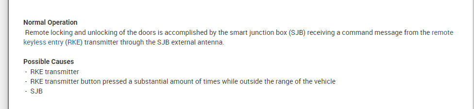

Keyless entry remote no longer works. Changed battery no luck. Tried reprograming and found door locks did not cycle open closed. Could not go further. Any ideas? Thanks
Jan 20, 2010 at 11:52 PM

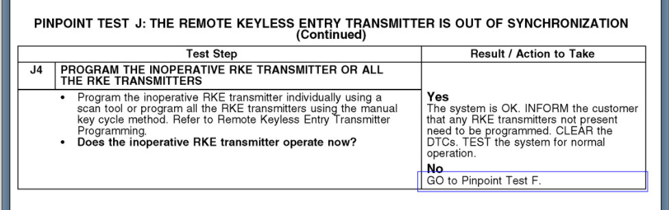

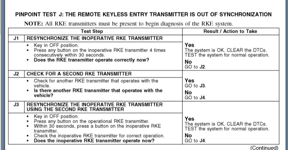

If this is the only issue then the likely issue is the remote is defective or out of sync with the module.
If you tried to program it and it did not work then I suspect you need to replace it.
https://www.2carpros.com/articles/how-to-re-program-a-key-remote-fob
However, below is the process from the manual on how to test this and what to do with what you find.
Please run through all this info and let us know what you find. Thanks
