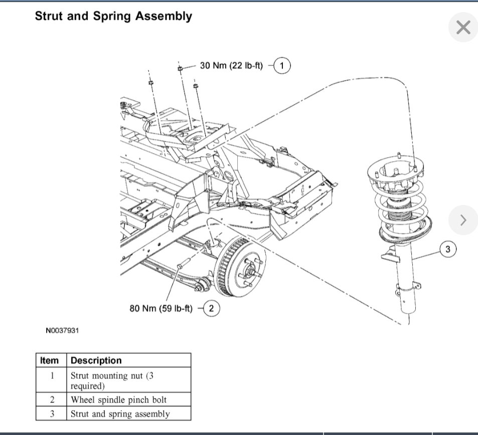

does the car listed above have rear strut assembly or does it have conventional shocks? I have seen both parts listed on auto part web sites.
Monday, December 28th, 2009 AT 8:58 PM
MECHANIC
18,907 POSTS

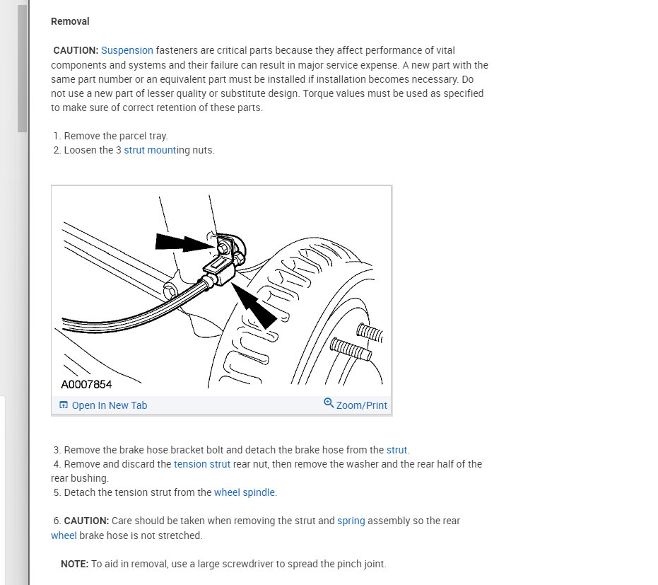

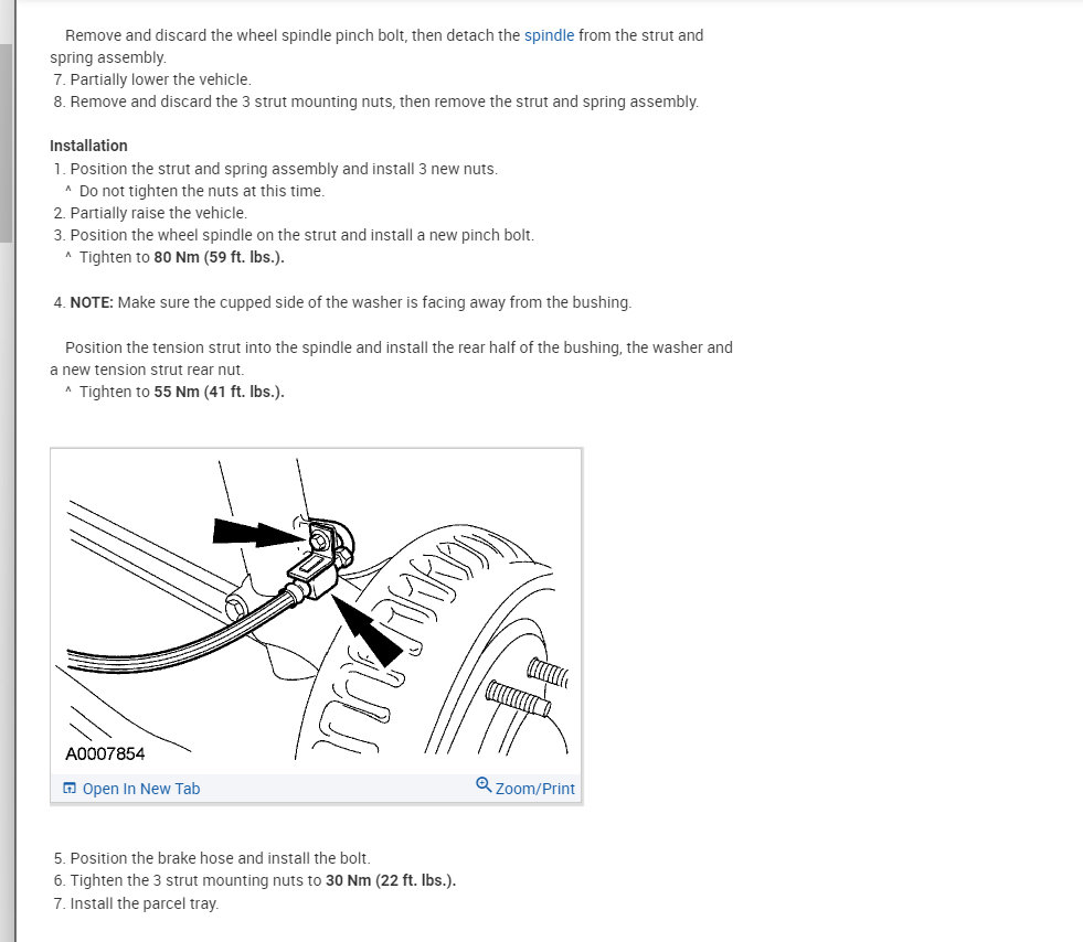

This vehicle has what is called a strut assembly. It is a strut and spring assembly, so the word strut and shock are commonly interchanged.
https://www.2carpros.com/articles/how-to-replace-a-suspension-strut-and-spring
I am attaching the info on the strut assembly. Please run through this and let me know what questions you have.
