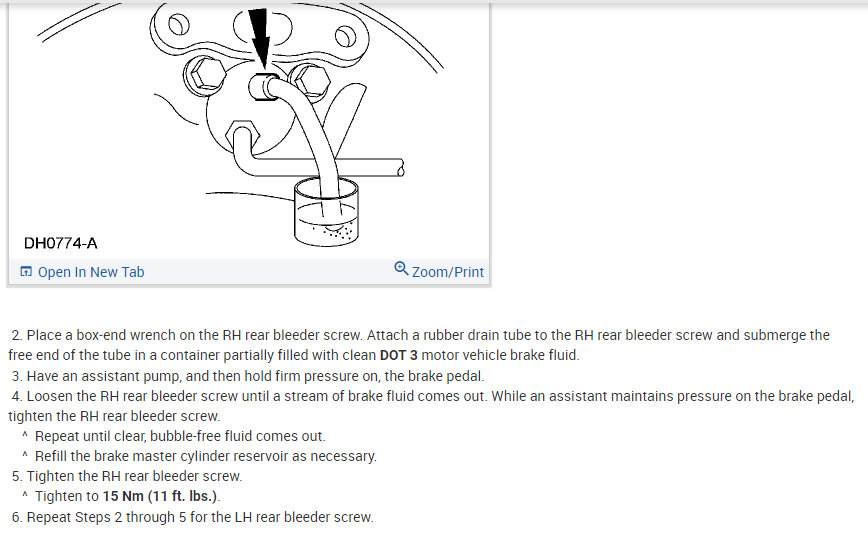

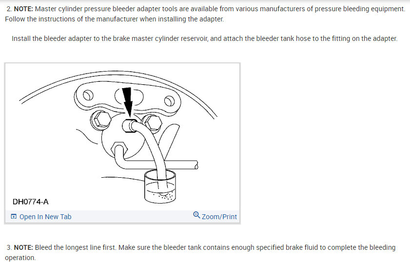

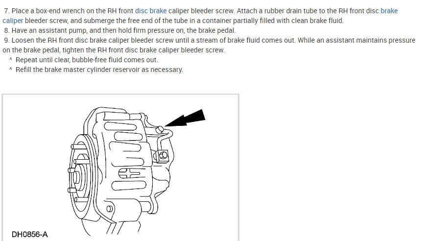

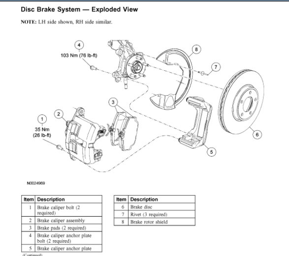

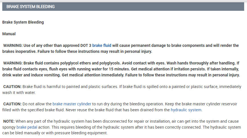

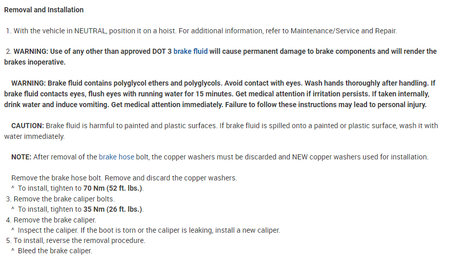

I got a two wheel brake service, left front new disc brake rotor, right front new brake rotor, clean and adjust rear brakes, and replaced my left front bearing. Since I have had these services done, I have had nothing but problems with my brake system. I noticed that when I traveled long distances that I would start to smell something near my front brakes burning. I would pull over and I could see the smoke coming from under the car near the driver's side brakes. When I got back in the car, the brakes would go all the way to the floor and would barely stop. So I checked it out and the brake flex hose on the right front is bad. Please help!
Dec 29, 2008 at 4:15 AM
DANNY L
  • 5,648 POSTS
Hello, I'm Danny.

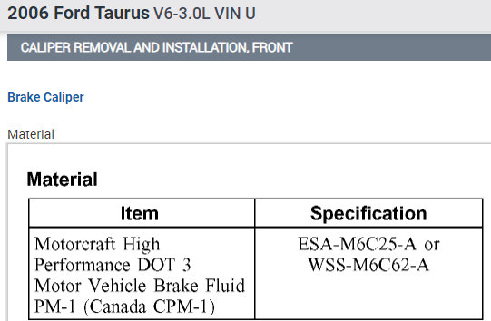

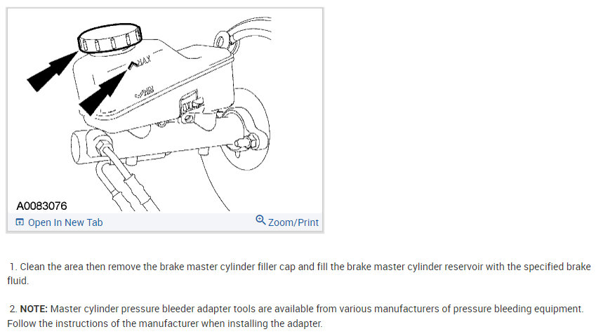

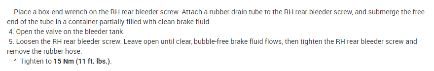

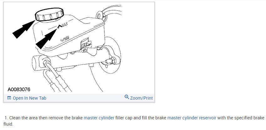

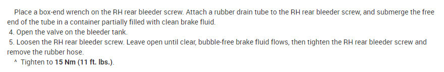

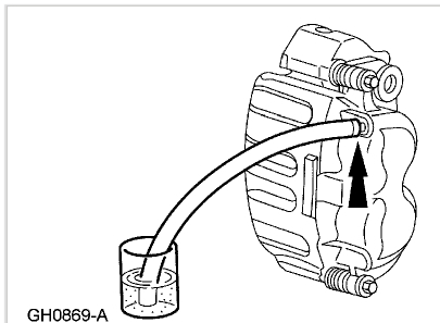

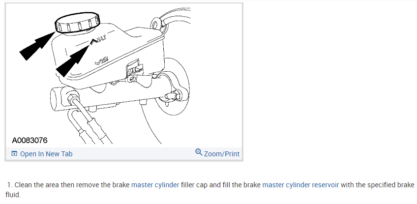

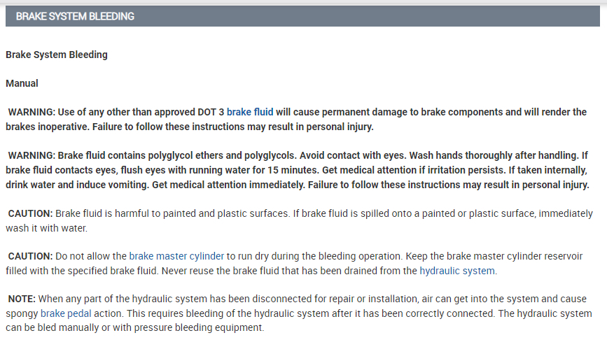

Here is the information you requested. Here is a guide to help you step by step with instructions in the diagrams below to show you how on your car how to bleed the brake system after replacing the brake line:
https://www.2carpros.com/articles/how-to-bleed-or-flush-a-car-brake-system
I've attached picture steps below on how to change the front brake line on your car and the brake bleeding procedure. Hope this helps and thanks for using 2CarPros.
