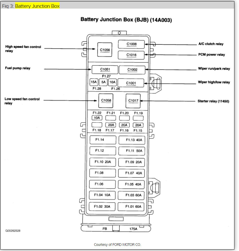

Hey there- My Taurus horn stopped working recently. I checked out the fusebox and verified I was looking at the right one (using the owner's manual) and it was fine.Do you have any thoughts on why a horn would stop working, and what can be done to fix it? BTW- where the hell is the thing located under the hood?
Thanks for any help you could provide.

It sounds like the horn itself went bad which happens all the time but to be sure lets do some simple testing. Here are some guides and diagram(below) that will help you get the job done.
you will need to get under the car safely
Here is a guide so you can check the relay as well.
Please let us know what happens so it will help others.

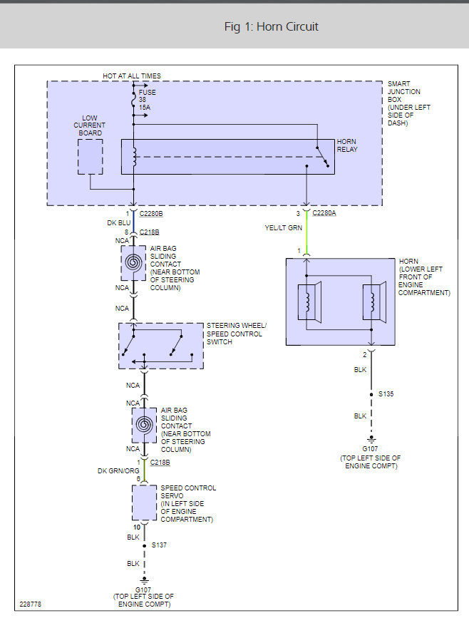

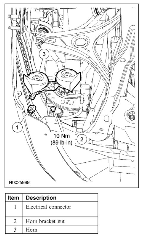

Horns are located on lower left front of engine compartment. You have to remove the headlamp for better access. Horn relay is inside the smart junction box under left side of dash. Fuse #38 15A controls it.
Focus: Same location for horn(s). Some have one, others have two horns. Smart junction box under left side of dash fuse #32 20A and a horn relay.

Unfortunately the insane engineers found a solution where there was no problem. Instead of the horn switch turning on the ten-dollar relay to blow the horn, the horn switch now sends a voltage to the most intelligent computer on the car, the instrument cluster, which interprets that and sends a digital signal to the FEM, (Front Electronic Module), which turns on the horn relay. That's right; two computers involved in blowing the horn. The typical repair bill for a dead horn is between $700.00 and $800.00. I hope to hear your bill is much less. The dealer will have to diagnose the problem. You've already done all you can with your dandy observation that the relay, fuse, and horns are okay.
If I had that circuit in my car, I'd be modifying it to work with the simple switch and relay like all cars had in the past. There's no need for this Rube Goldberg system. This isn't just a Ford thing. Most manufacturers are doing the same types of things to purposely make cars unnecessarily complicated and cost us way too much to diagnose and repair.

remove the pad and check the wire to the steering wheel it maybe lose.try grounding the contact in steering wheel with a test light.if still nothing you need to prob the turn signal switch harness connecter with the test light.if it works when you prob the turn signal harness connecter and not at the steering wheel contact its in the steering column.

We both forgot to mention the clock spring too. That has a higher failure rate than a computer module.

the procedure for removing says disconnect the electrical connector and remove a bolt and both hi and lo horns should come out as an assembly

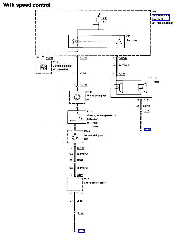

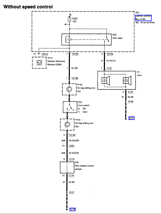

expose the dk blu wire that runs from the relay under the left side of the dash that runs to the bace of the steering column up to the horn switch. when the horn starts going off cut the wire and see if the horn stops. if yes then remove the horn pad and check the contacts. dont forget to repair the cut wire
Aug 15, 2020 at 5:30 AM (Merged)
FASTSTANG

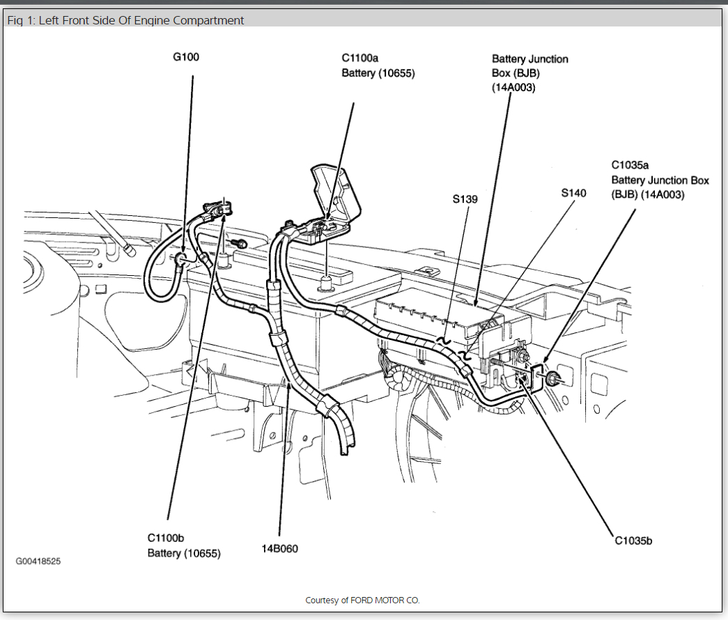

Electrical problem
2000 Ford Taurus 6 cyl Front Wheel Drive Automatic

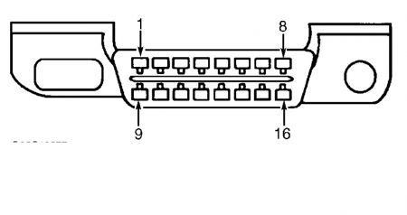

I have a 2000 taurus and my horn and OBD2 port are not working.I checked the fuse and the fuse was fine.
INTERNETMECHANIC
  • 700 POSTS

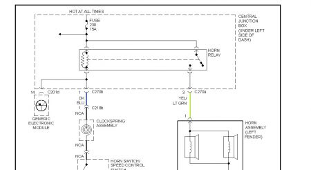

Did you use a voltage tester on the fuse circuit, to see if it is hot? Even if fuse is good, if no voltage, the circuit is dead. You could do some checking at the horn relay. The problem is usually the wiring circuit in the steering column, maybe you'll get lucky? At the datalink connector, pin 16 is voltage, hot all the time, fuse 230--15amp. Pins 4 & 5 are grounds.
https://images.2carpros.com/forum/automotive_pictures/512072_horn_circuit_taurus_1.jpg
https://images.2carpros.com/forum/automotive_pictures/512072_taurus_datalink_connector_1.jpg
