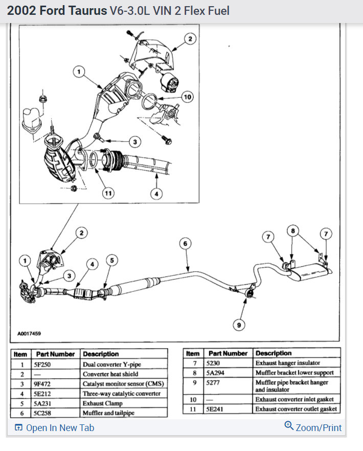

Here is a guide to help you step by step with instructions in the diagrams below to show you how on your car.
https://www.2carpros.com/articles/catalytic-converter-replacement
Catalytic Converter
Removal and Installation
1. With the vehicle in NEUTRAL, position it on a hoist. For additional information, refer to Maintenance/Service and Repair.
2. Remove and discard the 2 nuts and the muffler clamp.
^ To install, tighten to 40 Nm (30 ft. lbs.).
3. Remove the 2 catalytic converter-to-dual Y-pipe nuts and the catalytic converter.
^ Discard the nuts and the gasket.
4. NOTE: Clean the mating surfaces of the catalytic converter and the dual converter Y-pipe.
NOTE: To correctly seat the converters, alternately tighten the catalytic converter-to-dual converter Y-pipe nuts to specification.
To install, reverse the removal procedure.
^ Install new nuts, gasket and muffler clamp.

BMRFIXIT
  • 19,053 POSTS
Many after market replacement should fit and work just fine need to have you engine size and code
https://images.2carpros.com/forum/automotive_pictures/99387_1_34.jpg
https://images.2carpros.com/forum/automotive_pictures/99387_2_14.jpg
https://images.2carpros.com/forum/automotive_pictures/99387_3_10.jpg
