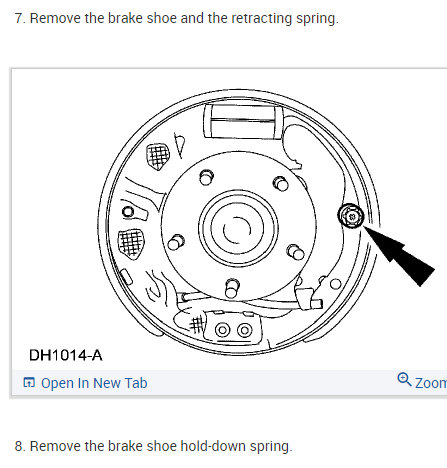

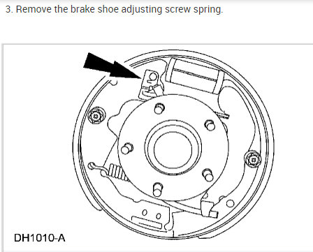

I got a front brake job about 2 months ago with new rotors. Just recently my parking brakes started to not hold I think I need new ones.
Jun 29, 2008 at 11:37 AM
DANNY L
  • 5,648 POSTS
Hello, I'm Danny.

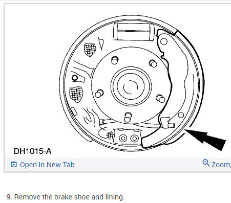

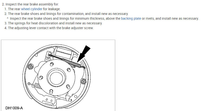

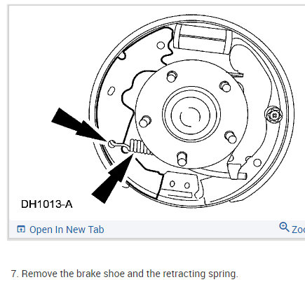

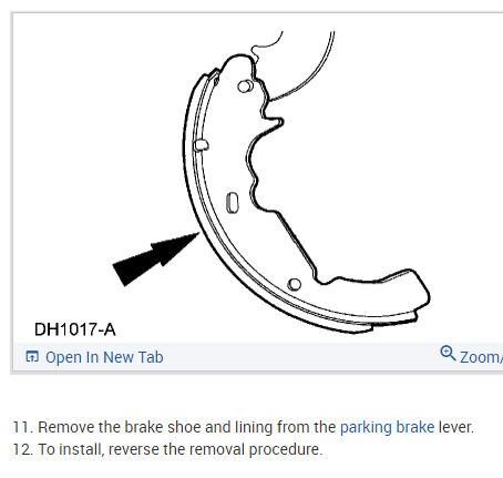

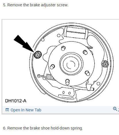

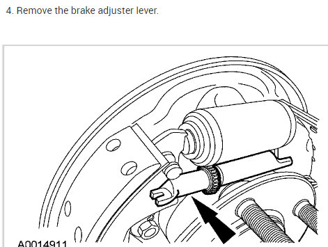

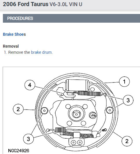

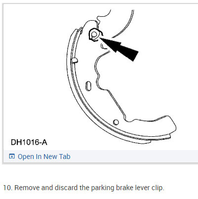

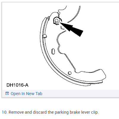

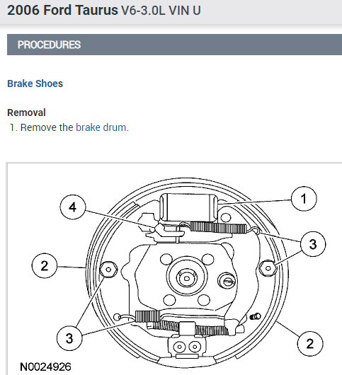

Here is the information you requested. Here is a tutorial on how to remove and replace rear parking brake shoes:
https://www.2carpros.com/articles/parking-brake-shoe-replacement
I've attached picture steps below on how to replace the parking brake shoes on your car. Hope this helps and thanks for using 2CarPros.
