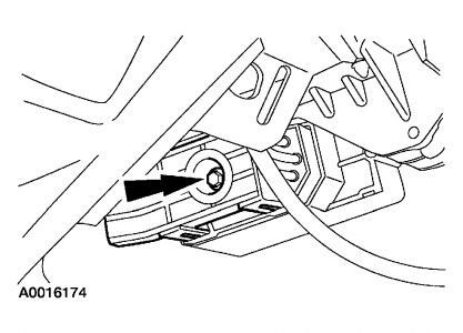

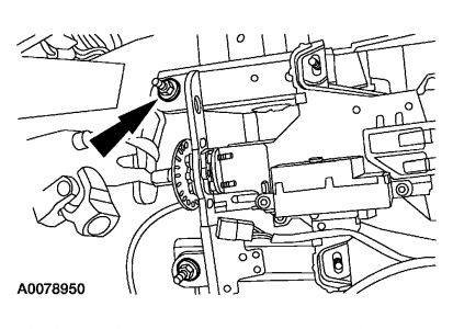

2005 Ford Taurus 6 cyl Front Wheel Drive Automatic
I was told my problem I was having could be my ignition switch. is it the same as the key cly?if not where is it? thank you
Dec 3, 2008 at 10:11 AM
BMRFIXIT
  • 19,053 POSTS
Ignition Switch and ignition key cylinder two different parts and locations ignition switch located at the steering column about a foot below the ignition key on the steering column look for the wiring good luck
https://images.2carpros.com/forum/automotive_pictures/99387_Graphic1_103.jpg
https://images.2carpros.com/forum/automotive_pictures/99387_Graphic2_53.jpg
