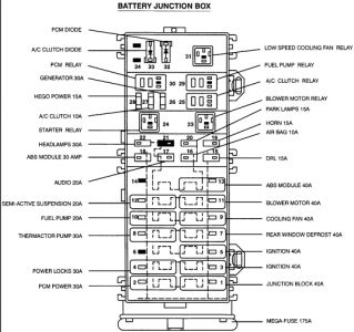

WRENCHTECH
  • 20,761 POSTS
This car has a 2 speed fan system and the 2 speeds are controlled by separate relays so chances are slim that a relay is the problem however they are both powered by the same fuse. The location is shown in the diagram. If you do find the fuse blown, it could be an indication of an overload problem from the fan motor itself.
https://images.2carpros.com/forum/automotive_pictures/561653_Relays_99_Taurus_1.jpg
Aug 24, 2020 at 10:49 AM (Merged)
TISENHOUR
  • 5 POSTS
So I am assuming number 9 is the cooling fan fuse since since the other cooling fan slot is for the relay? So I should get two relays and one fuse so I can properly test correct?? Sorry I dont know the first thing about cars and trying to do this on a budget
WRENCHTECH
  • 20,761 POSTS
With the ability you seem to have you are going o be very limited here. About all you can do yourself is replace the fuse. Anything beyond that is going to require some in depth electrical testing and I don't think you will be able to grasp that.

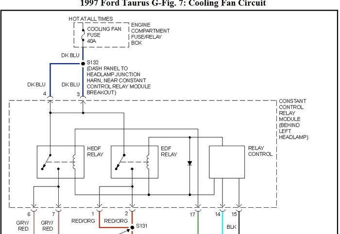

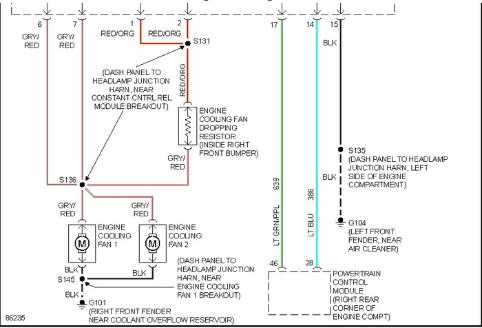

JDL
  • 16,098 POSTS
fordparts.com has online owners manuals. When the site comes up, click on pro center, then click technical resources. In the left column, click owners guides. It will ask for year and model.
Any applicable trouble codes? I'll post the wiring diagram for fan.
Aug 24, 2020 at 10:50 AM (Merged)
JDL
  • 16,098 POSTS
taurus fan one.
