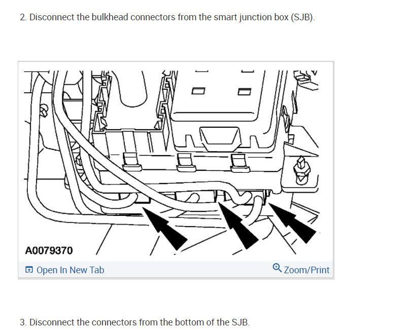

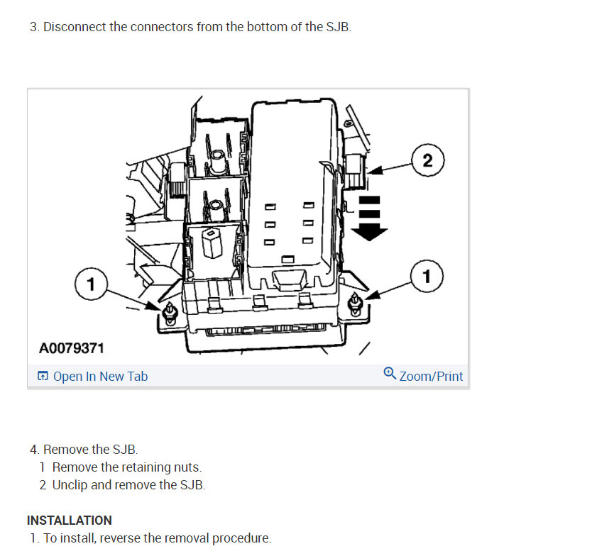

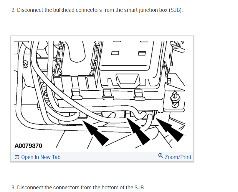

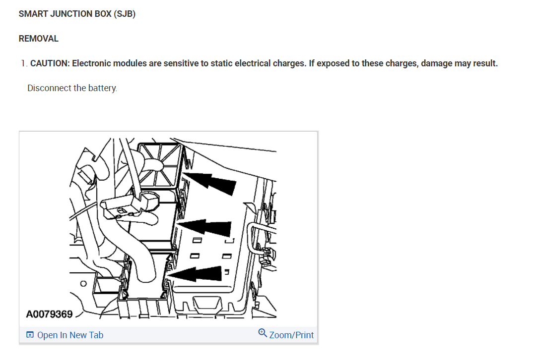

I attached the location for you below of the module.
