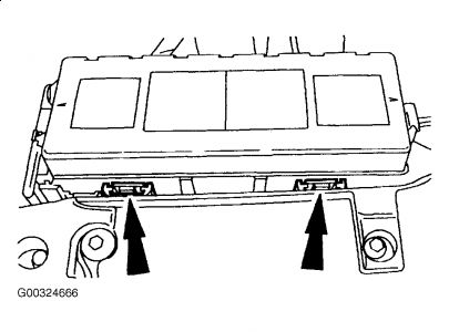

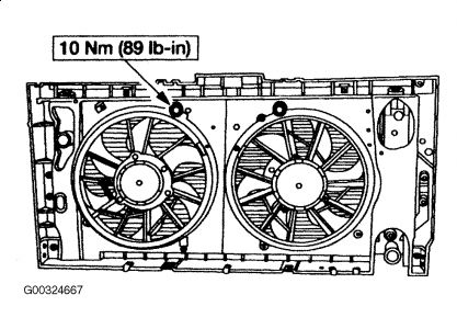

RFRANCE
Engine Cooling problem
2002 Ford Taurus 6 cyl Front Wheel Drive Automatic
How can I replace the coolinf fan on the right side of the engine
Aug 25, 2020 at 3:59 AM (Merged)
BMRFIXIT
  • 19,053 POSTS
Remove the distribution box and position aside. See Fig. 1 . Disconnect the fan electrical connector and detach the retainer. Remove the bolt and the electrical cooling fan. See Fig. 2 . To install, reverse the removal procedure. Tighten bolt to specification
