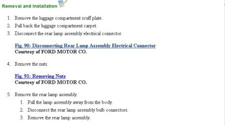

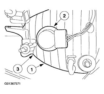

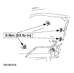

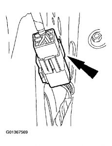

How do i replace the tail light/brake light bulb?
Feb 10, 2009 at 1:09 AM
ZACKMAN
  • 4,202 POSTS
https://images.2carpros.com/forum/automotive_pictures/55316_04taurustail_1.jpg
https://images.2carpros.com/forum/automotive_pictures/55316_04taurustail_2.jpg
https://images.2carpros.com/forum/automotive_pictures/55316_04taurustail2_1.jpg
https://images.2carpros.com/forum/automotive_pictures/55316_04taurustail3_1.jpg
install is reversed.
