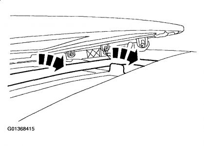

What causes the sunroof to sag after it has been closed? Is there any type of adjustment that can be made?
May 8, 2009 at 9:51 AM
BMRFIXIT
  • 19,053 POSTS
Adjusting bolts two on each side ***************************************** need manual CHECK IT @ https://www.2carpros.com/kpages/auto_repair_manuals.htm
https://images.2carpros.com/forum/automotive_pictures/99387_Graphic1_331.jpg
