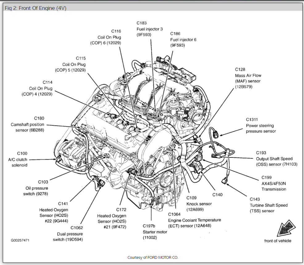

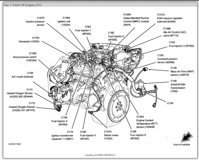

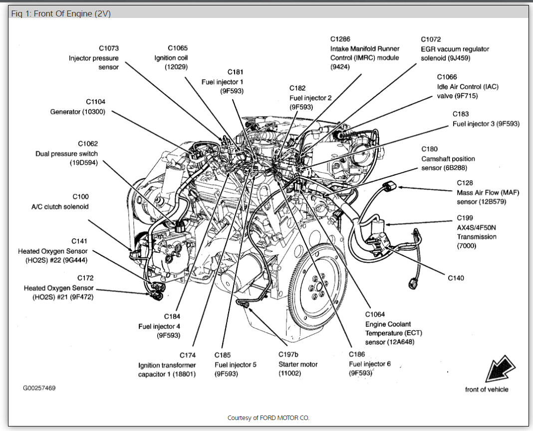

Hello MERLIN2021. I have a 2004 Ford Taurus SES 3.0 DOHC V6. I am coming up with 4 codes now, but it changes. What I mean is one time I will have 2 codes, then another time I will have 3, and now I have 4. The codes are P0300, P0301, P0304, and P0316. All misfires. I have changed all 6 coils, all 6 spark plugs, fuel injector on cylinder 4, fuel filter. When I first bought the car it only had a misfire on startup and on cylinder 4. I changed the coil and spark plug on cylinder 4 the 2nd day i owned car. Since that didn't fix the problem I changed the injector. For some reason the misfire keeps bouncing. There is a slight stumble when I first startup and when it idles to long. Also, stumbles at low speed. I also have low oil pressure.
Jul 21, 2017 at 1:34 PM
  • 55,224 POSTS
What happens is the mixture is a little off causing the misfire codes. 9 times out of 10 it is the MAF sensor that needs to be replaced due to the sensor wire getting contaminated. Here is a guide that will give you an idea on what you are in for when changing the sensor.
https://www.2carpros.com/articles/how-to-replace-a-mass-air-flow-sensor-maf
Here is a diagram (below) on what it will be like on your car. It just shows the wiring that goes to the sensor which is in the air intake tube.
https://www.2carpros.com/articles/replace-an-air-intake-boot
