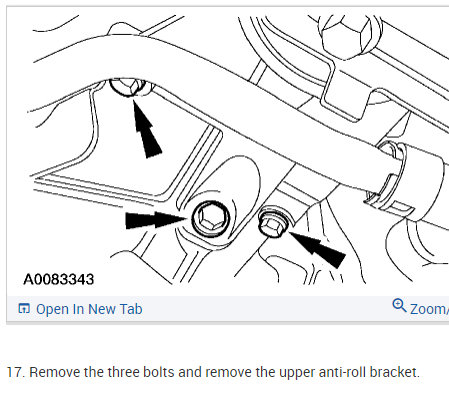

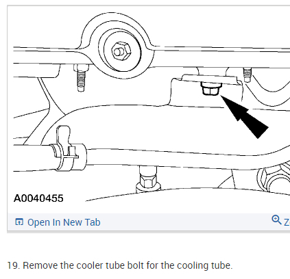

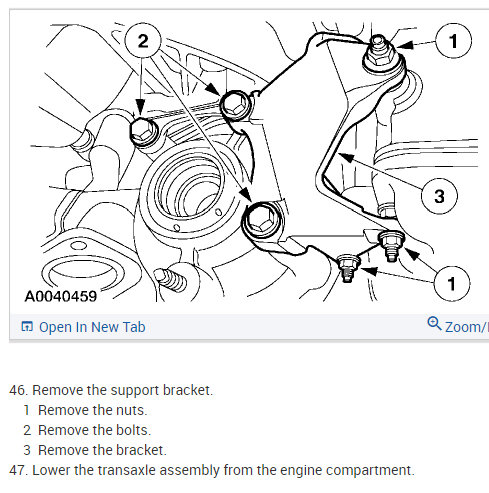

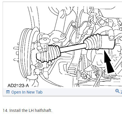

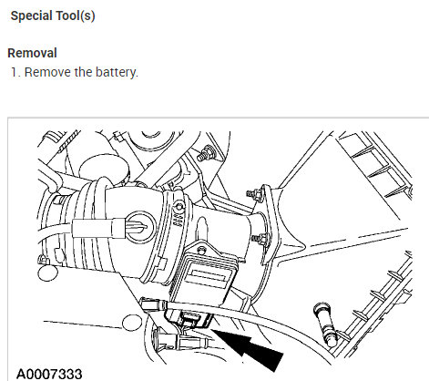

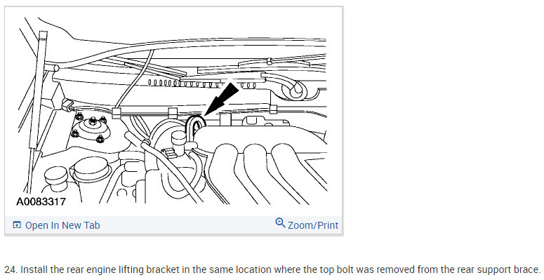

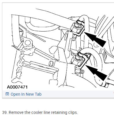

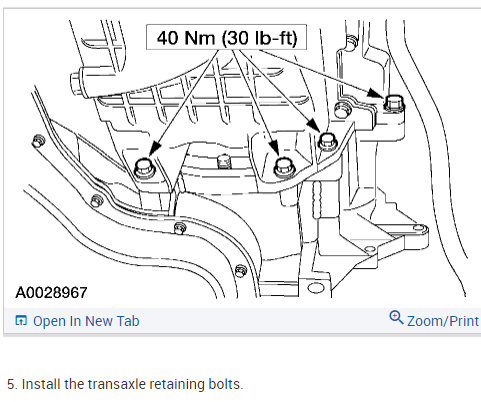

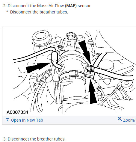

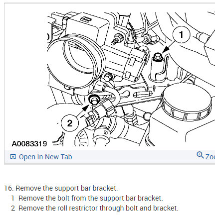

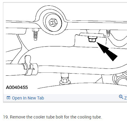

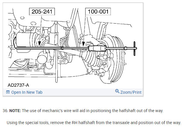

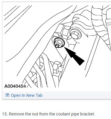

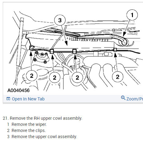

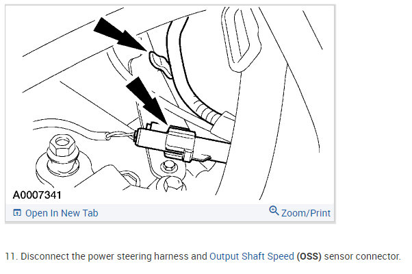

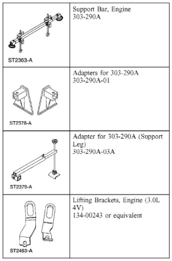

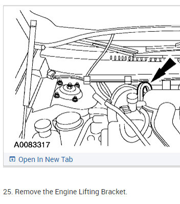

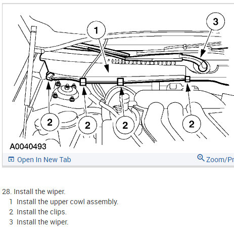

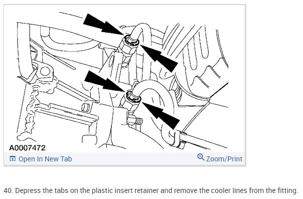

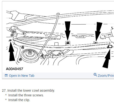

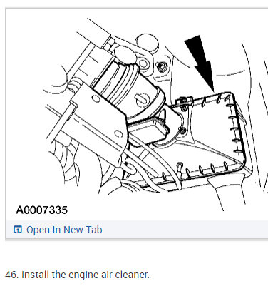

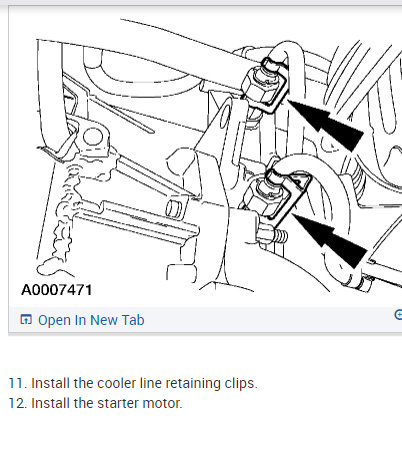

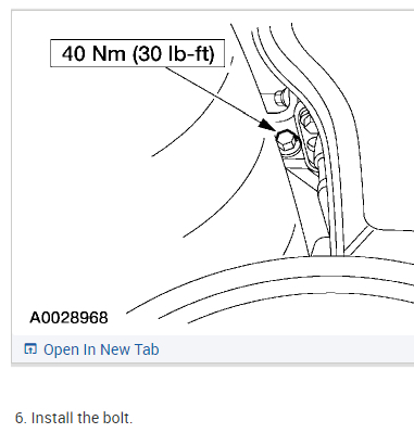

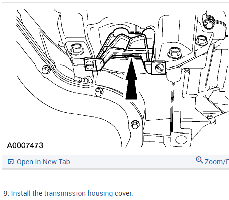

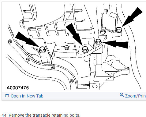

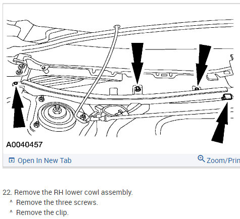

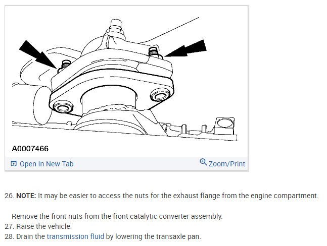

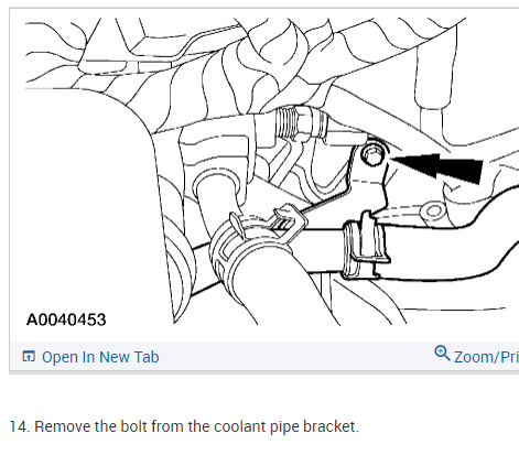

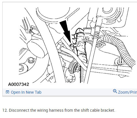

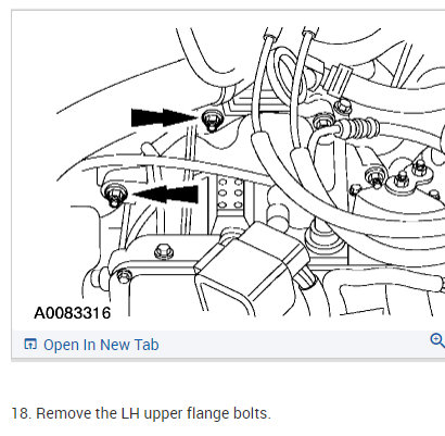

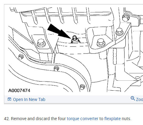

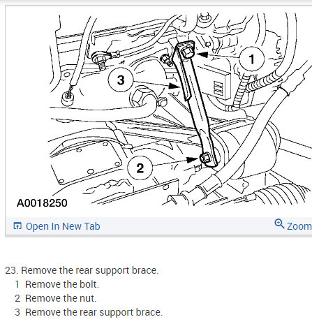

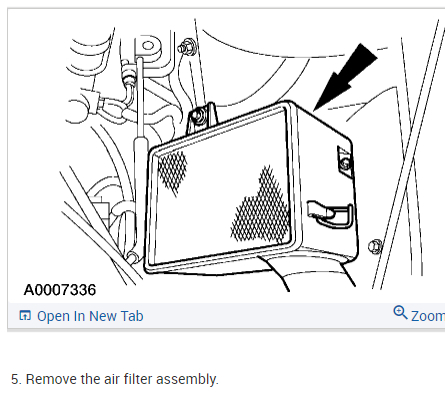

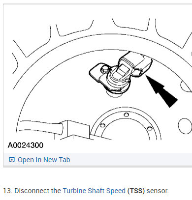

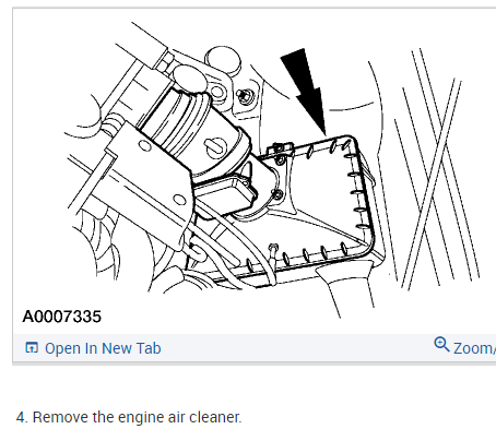

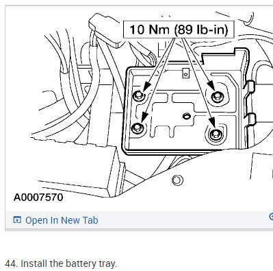

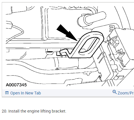

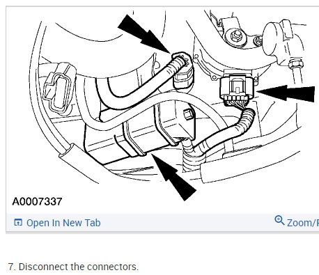

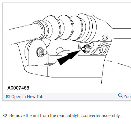

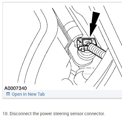

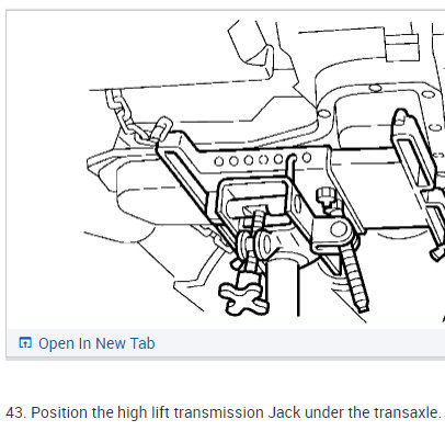

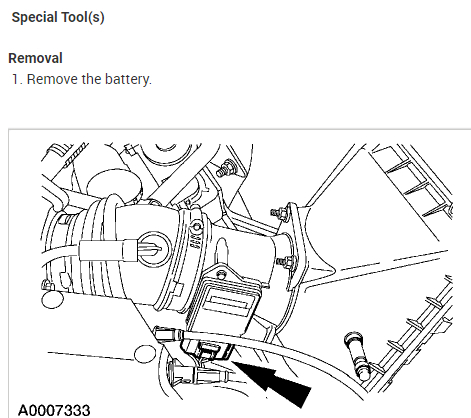

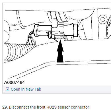

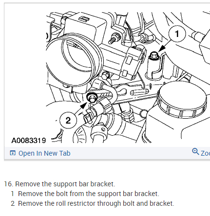

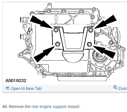

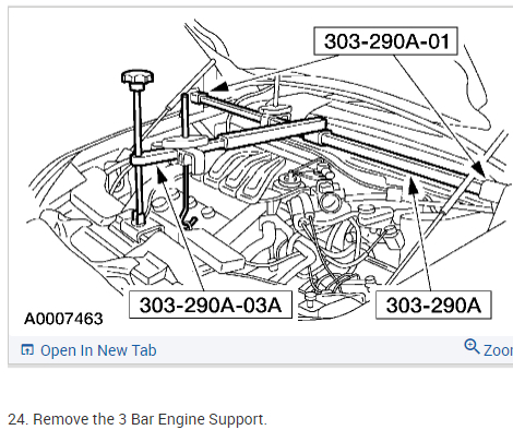

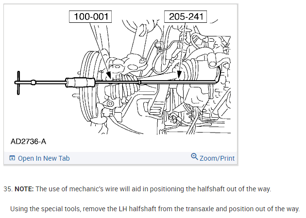

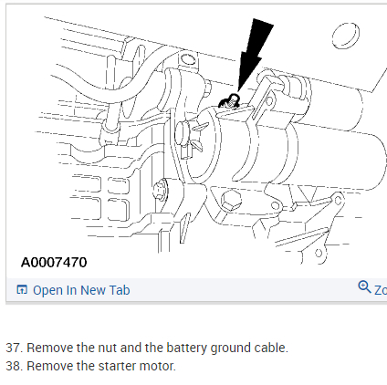

We were just told to rebuilt the transmission but I need to take it out first can you help me?
Aug 28, 2009 at 11:09 AM
DANNY L
  • 5,648 POSTS
Hello, I'm Danny.

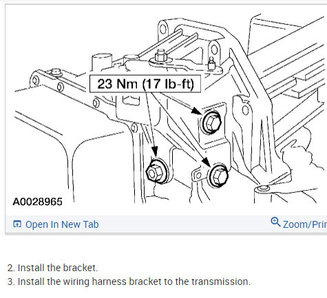

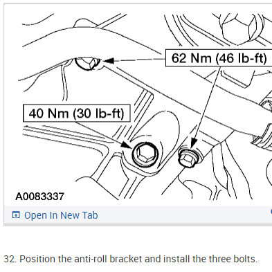

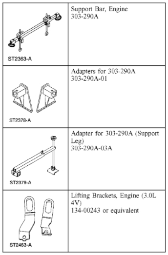

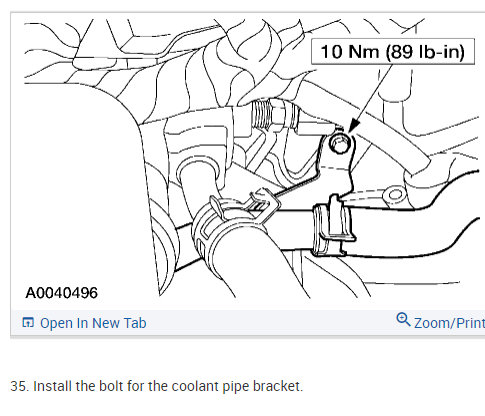

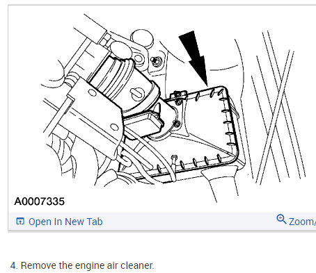

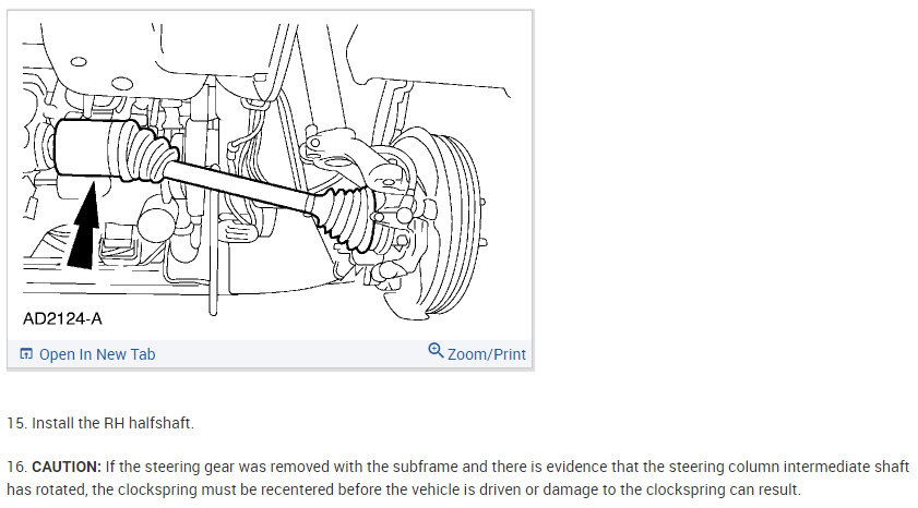

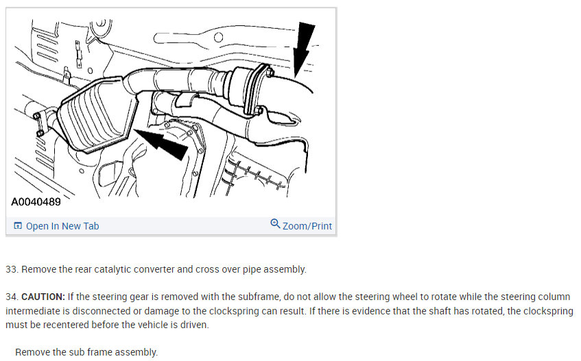

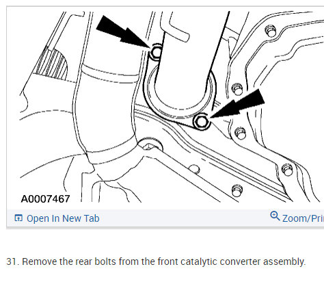

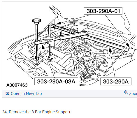

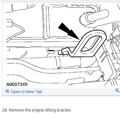

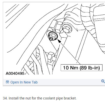

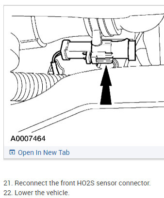

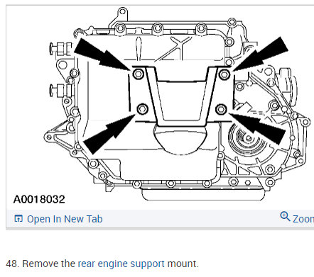

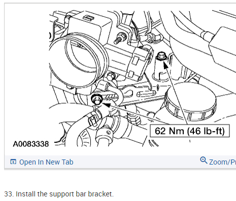

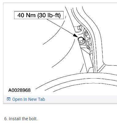

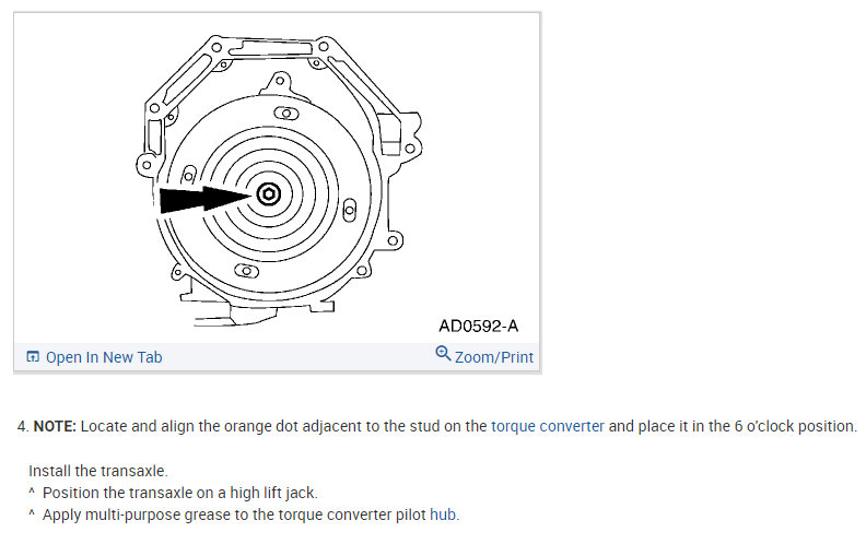

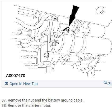

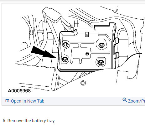

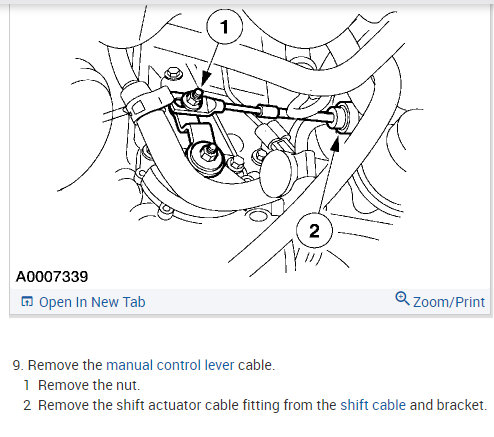

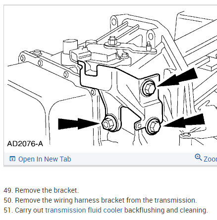

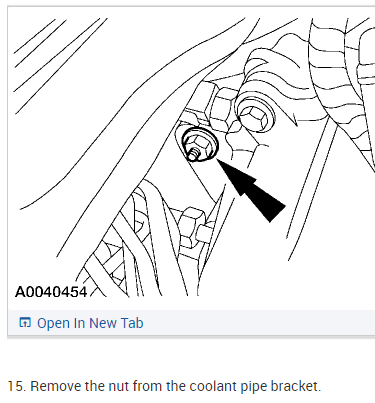

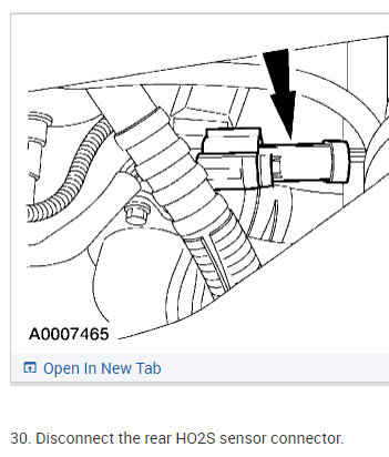

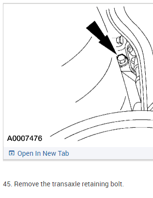

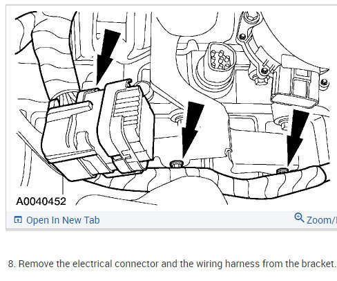

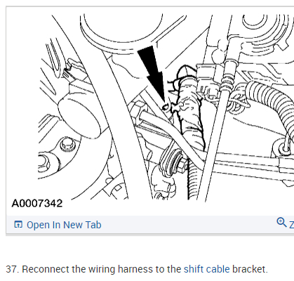

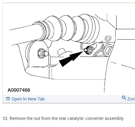

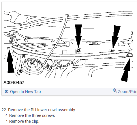

Here is the information you requested. I will have to send you 2 posts due to the sheer number of picture steps. This is page 1. Here is a tutorial for you to view showing how to remove a manual transmission which is similar:
https://www.2carpros.com/articles/transmission-replacement-removal-manual

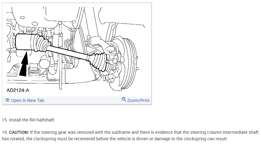

I've attached picture steps below showing how to remove the automatic transaxle on your car. Hope this helps and thanks for using 2CarPros.
Apr 21, 2021 at 3:35 AM

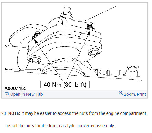

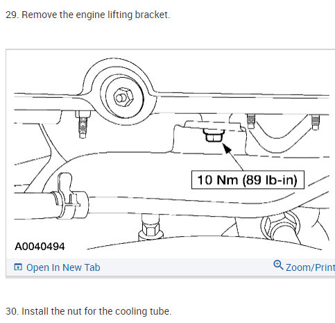

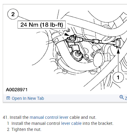

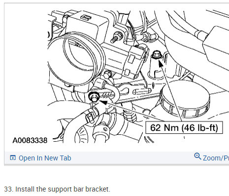

DANNY L
  • 5,648 POSTS

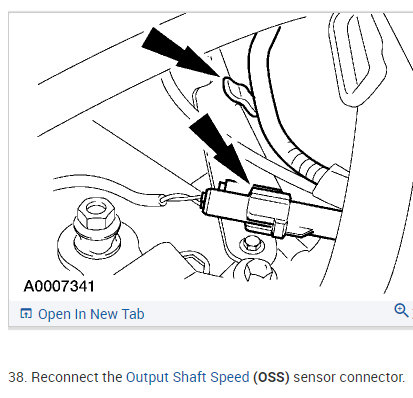

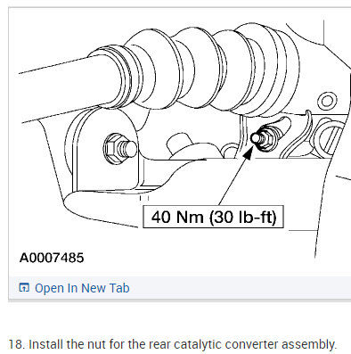

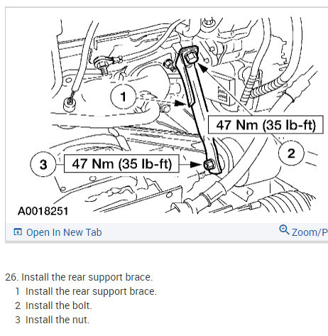

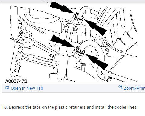

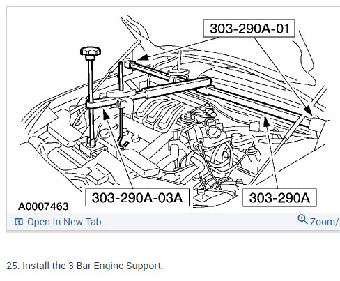

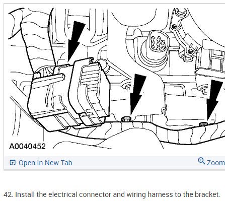

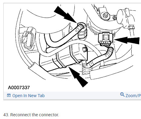

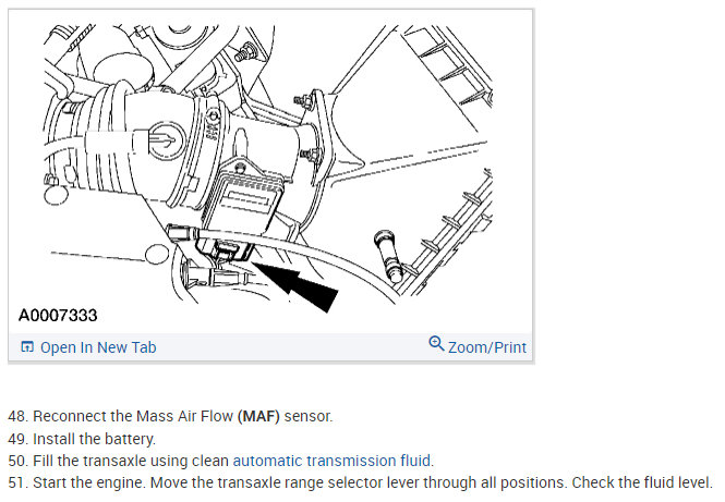

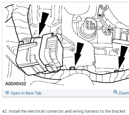

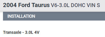

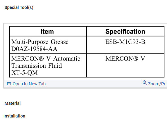

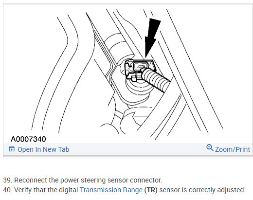

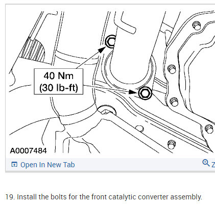

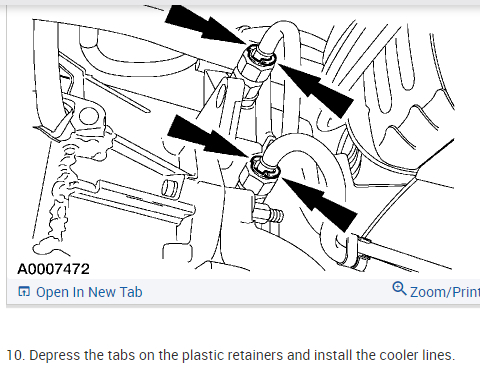

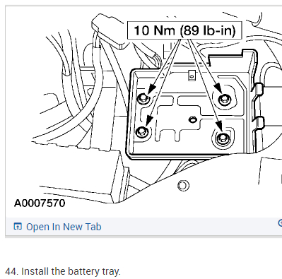

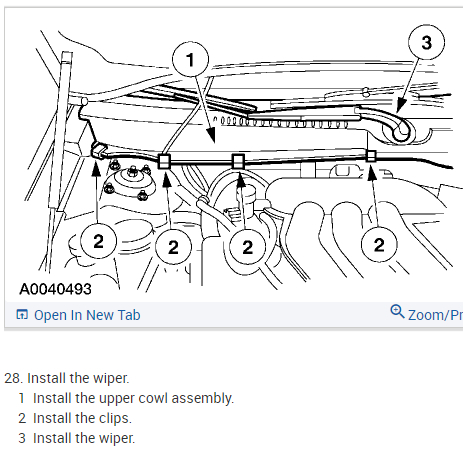

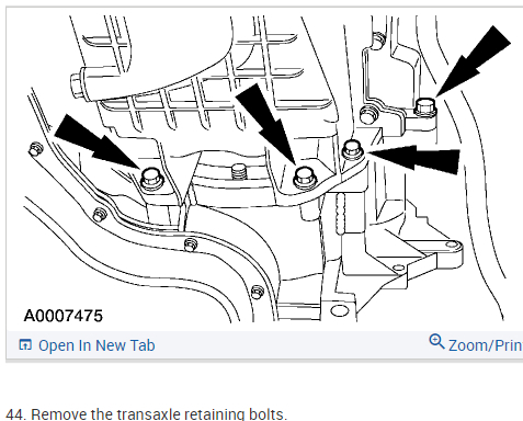

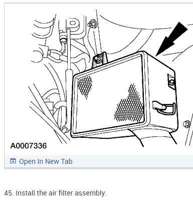

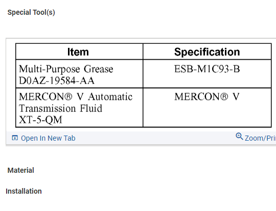

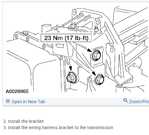

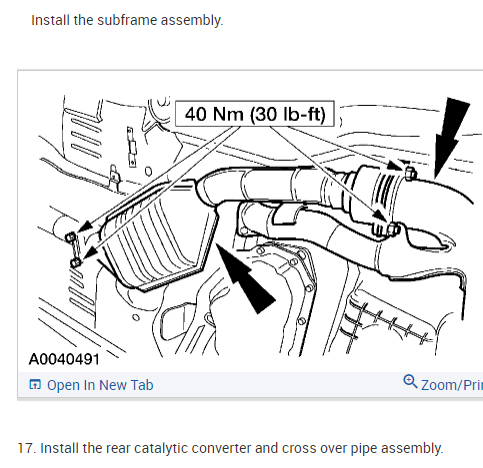

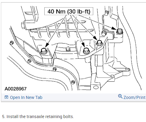

Hello, I'm Danny.

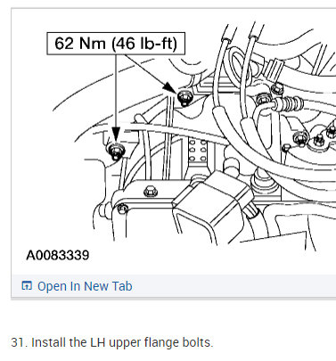

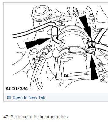

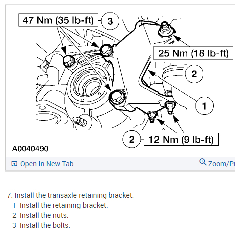

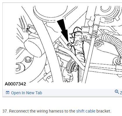

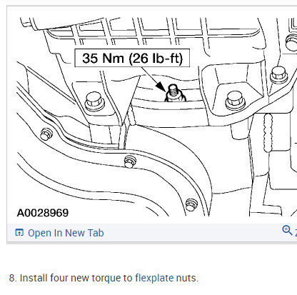

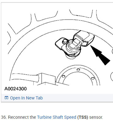

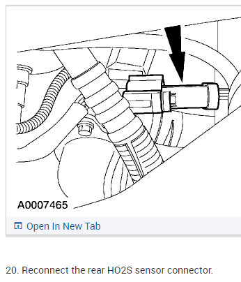

Here is the information you requested. I will have to send you 2 posts due to the sheer number of picture steps. This is page 2. I've attached picture steps below showing how to install the automatic transaxle on your car. Hope this helps and thanks again for using 2CarPros.
