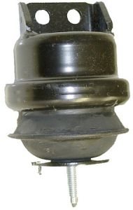

i have a squeak in my car when i touch the gas or change from N to D or R. When I checked with a friend we found the engine shifts back tworard the firewall. Like a broken motor mount .I cant find motor mounts in any catalog. I also can move the engine back to the firewall by hand when turned off and it squeaks. Do i have a broken mount on my trans? Or is it an engine mount and if so where are they?

Assuming that you have the OHV engine (the most common engine, 8th digit of VIN "U"), you have two engine mount and one transmission mount. Front right Anchor Mount 2894
https://images.2carpros.com/forum/automotive_pictures/55316_2894_1.jpg
Rear right 2973
https://images.2carpros.com/forum/automotive_pictures/55316_2973_1.jpg
Transmission mount 2974
https://images.2carpros.com/forum/automotive_pictures/55316_2974_1.jpg
