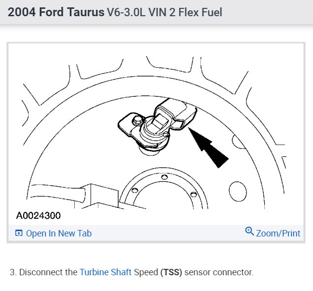

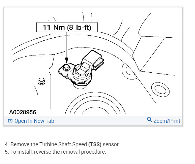

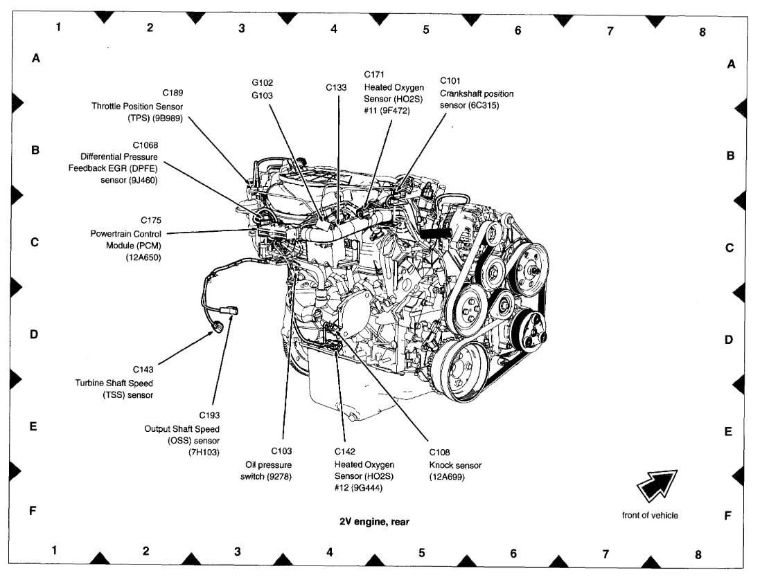

DOCFIXIT
  • 18,828 POSTS
This usually happens when a turbine sensor goes out but th be sure lets run the codes here is a guide to help us get started
Aug 4, 2019 at 4:30 AM (Merged)
LHTEDYBEAR
I had this problem the sensor fixed it FYI cost me $76.00
