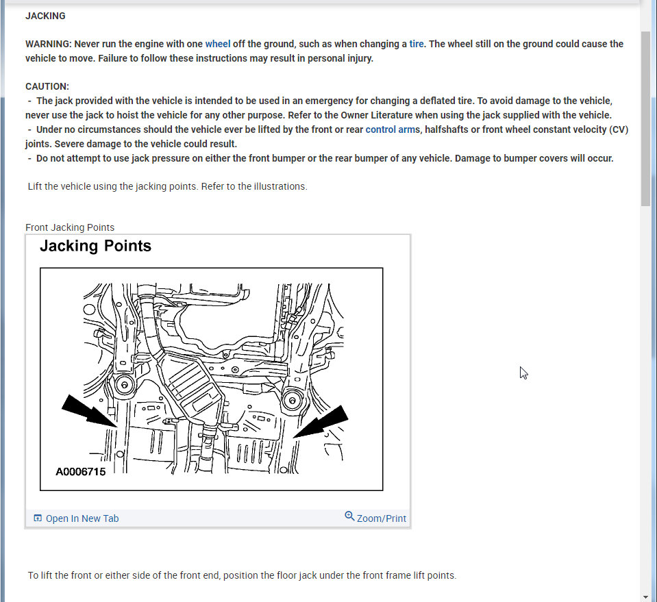

jack points?
40,000 MILES • 6 CYL • FWD • AUTOMATIC
DRPOUNDSIGN
basic I know. But I could not find the jacking notch with all the plastic on that car. Also I have trouble replacing the jack in the spare tire wheel well.
Thanx

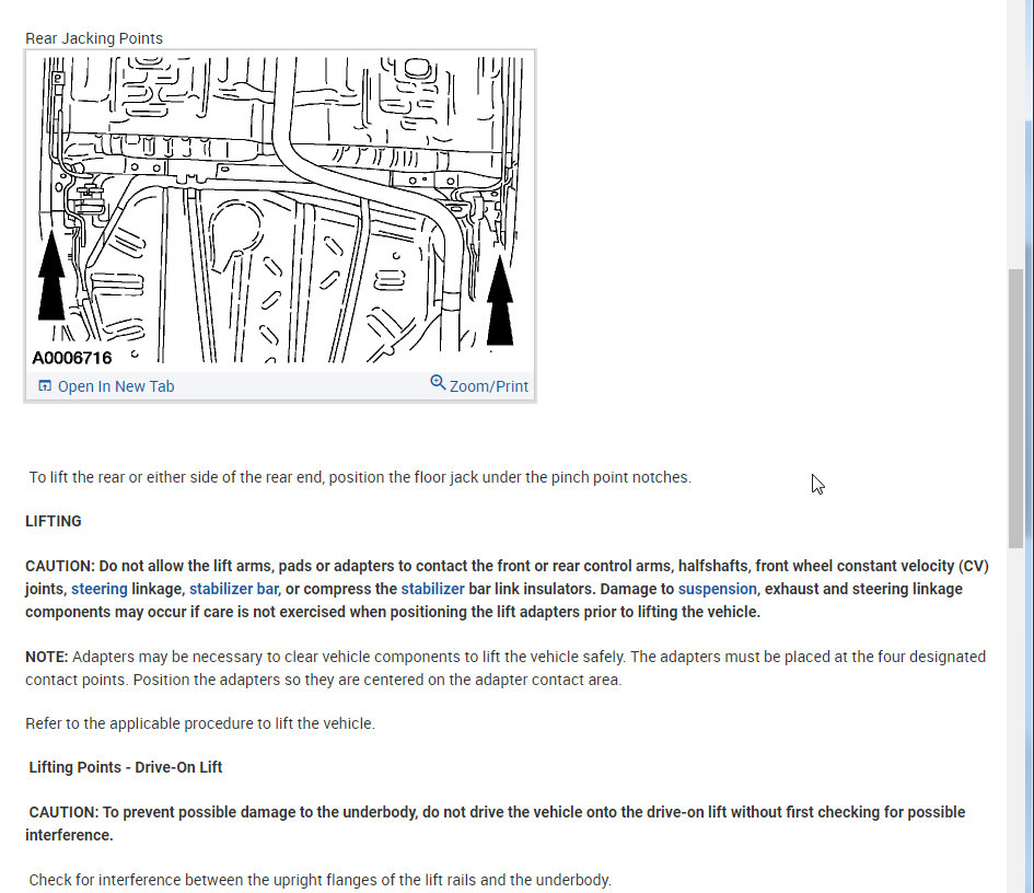

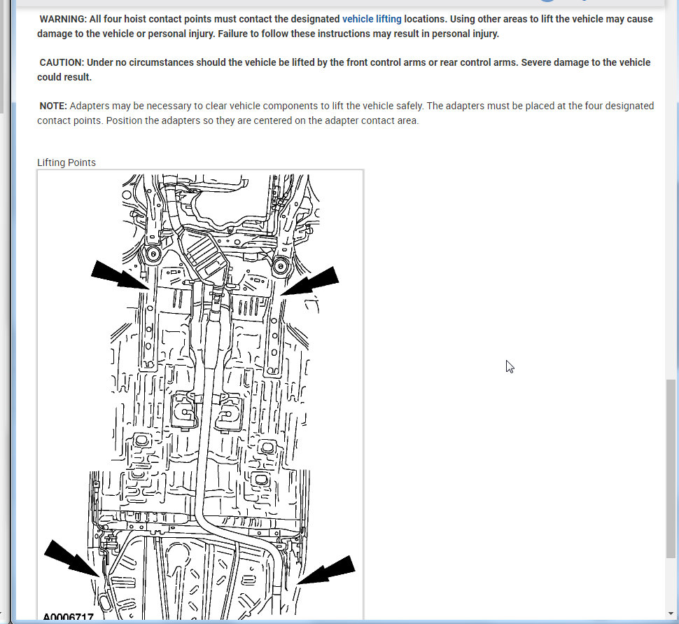

Here is the info from the manual on how to lift this vehicle with diagrams on where to lift it.
Plus here is a guide that will help with lifting a vehicle:
Below is the info from the manual.
Let us know if you have questions. Thanks
