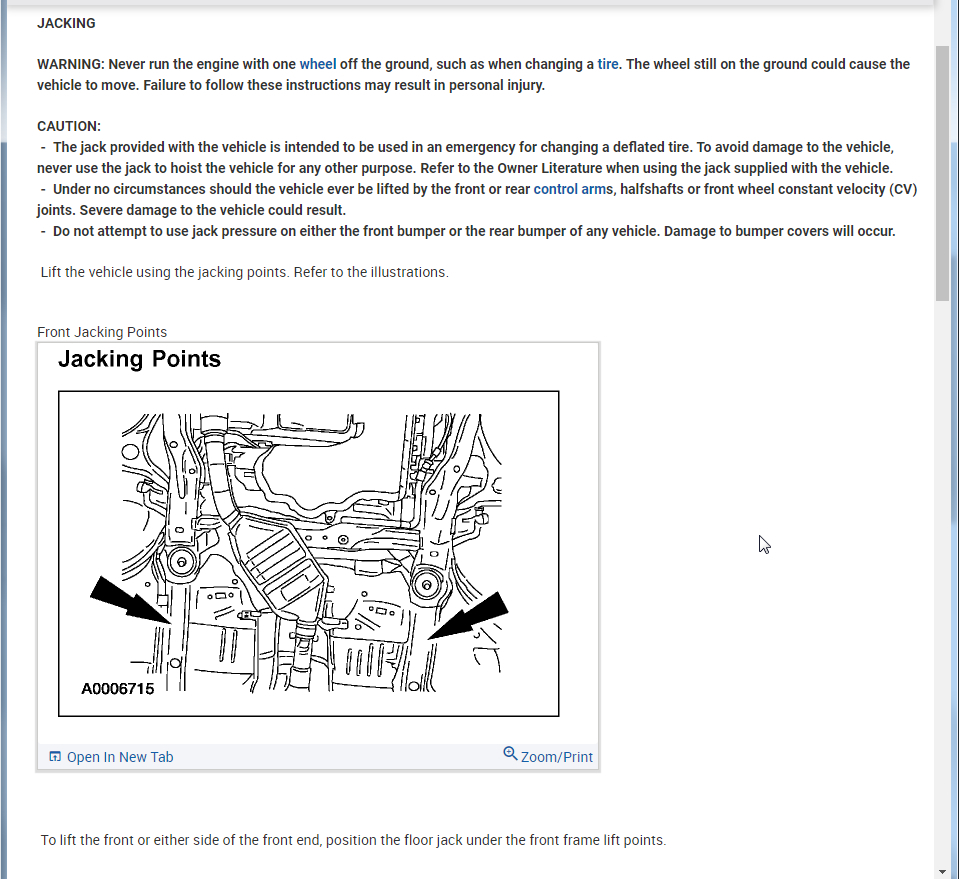

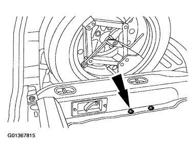

basic I know. But I could not find the jacking notch with all the plastic on that car. Also I have trouble replacing the jack in the spare tire wheel well.

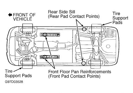

This is what I have hope it help here is a video to check out https://youtu.be/xLFn_bMkZc0
https://images.2carpros.com/forum/automotive_pictures/99387_Graphic_39.jpg

https://images.2carpros.com/forum/automotive_pictures/99387_Graphic1_17.jpg
This is what I have hope it helps

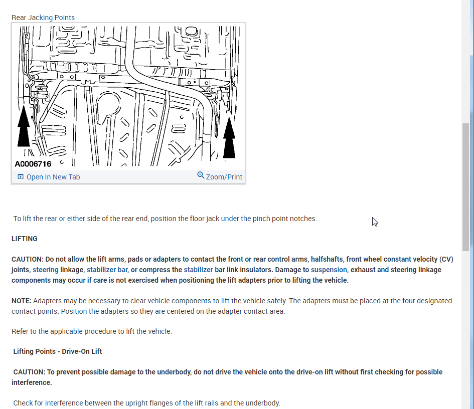

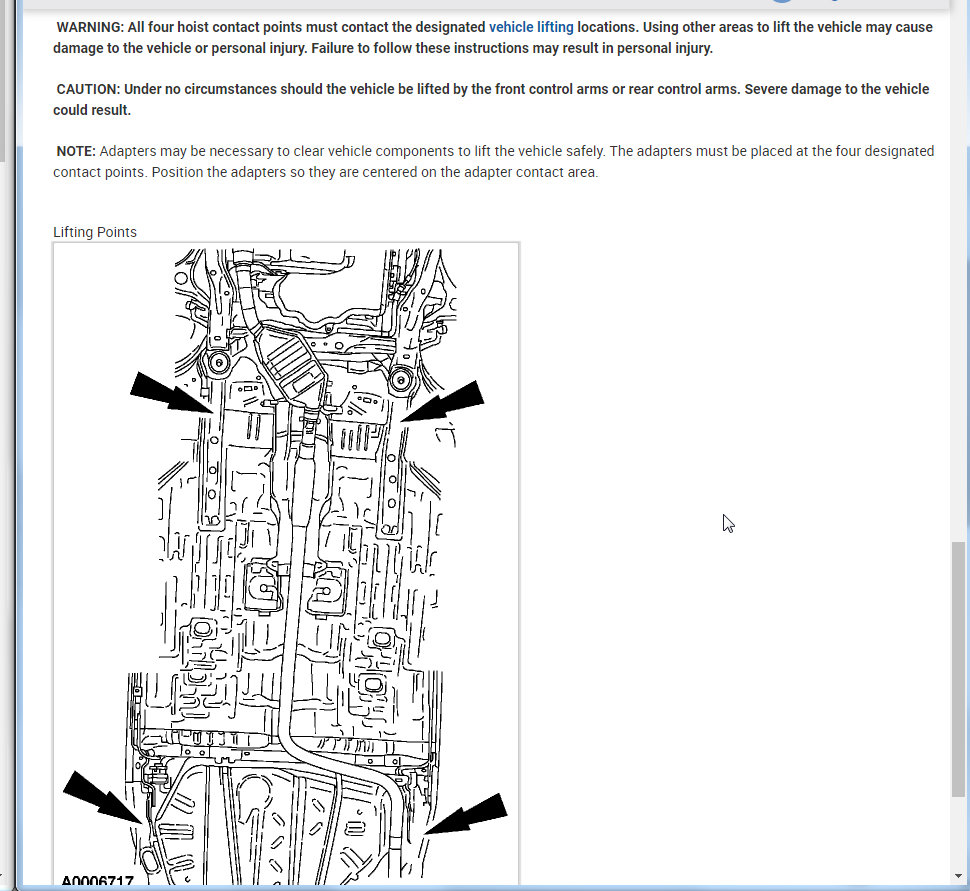

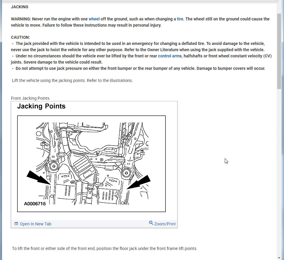

Here is the info from the manual on how to lift this vehicle with diagrams on where to lift it.
Plus here is a guide that will help with lifting a vehicle:
Below is the info from the manual.
Let us know if you have questions. Thanks
