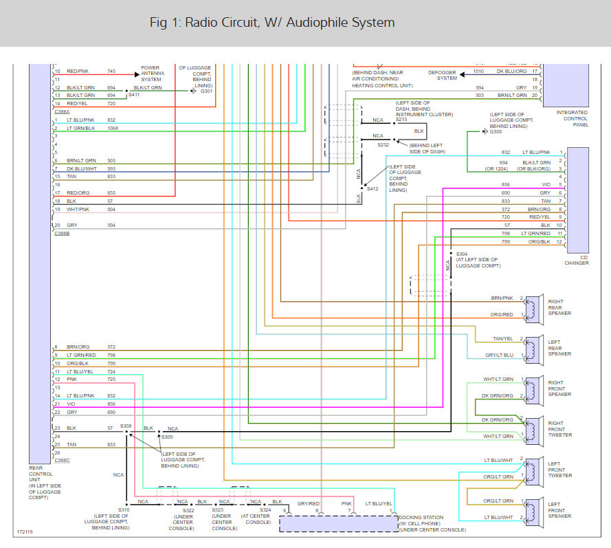

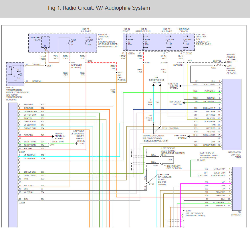

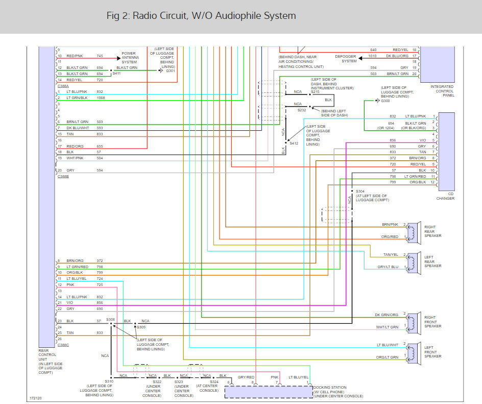

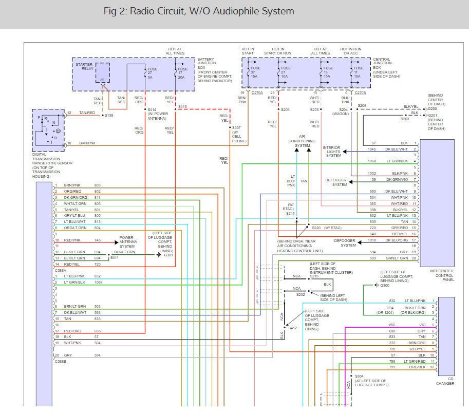

Hi 2 Car Pros,
I am installing a stereo amplifier to the stock deck of my '03 Taurus. I have the device needed to create RCA outputs, however I can't figure out which wires are the stereos rear speaker wires. I know that there is a module located in the trunk of the vehicle where the rear speaker wires come from, but I don't know the color codes for those wires. I would appreciate any assistance in this matter. Also, for the connection of the amplifier, I need to locate an accessory wire. Is there one located in the trunk along with the speaker wires? Or do I have to dig around under the dash? If so, can you please tell me which wire I can tap into? Again, I appreciate any help with this matter. Thank you.

Here is a wiring guide and the radio wiring diagrams for both radios this car came with just to be sure you get what you need.
Cheers
