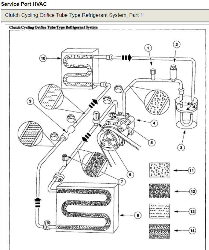

It is easy to find follow the large tube from the firewall that goes to the rear of the compressor it will be on that line. Here is a video and guide that should be able to help.

Look on the passenger side for the aluminum accumulator, the service port is on it, The high side is a smaller port, so the hose end won't fit it anyway, charge with the can in the upright position only..this way it dispenses gas and will not damage the compressor.

Usually its located on or around the accumulator

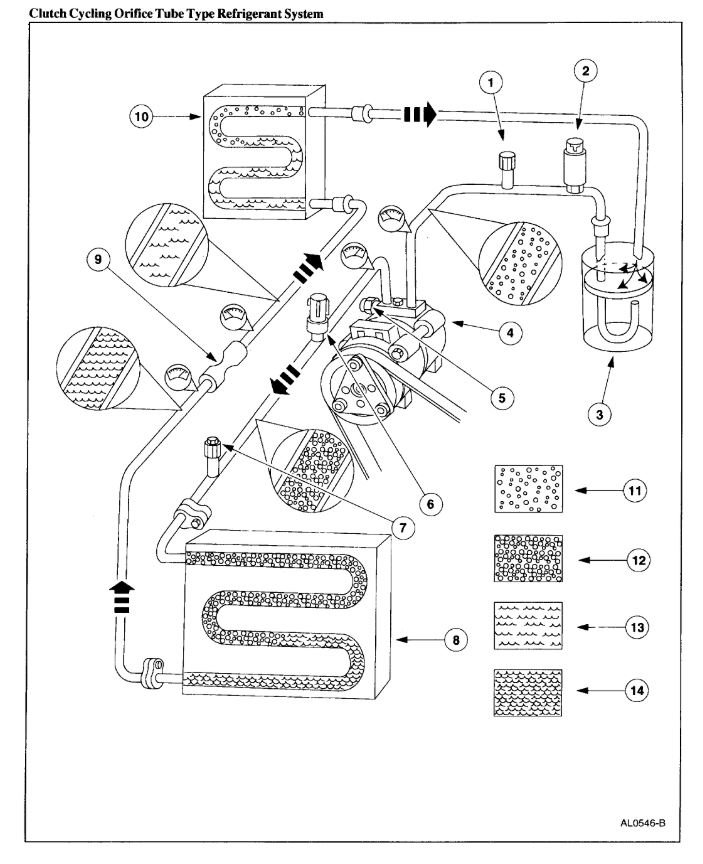

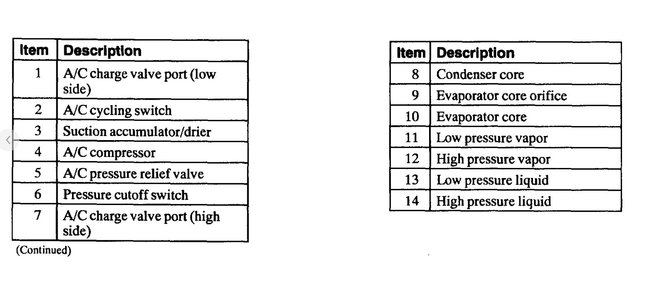

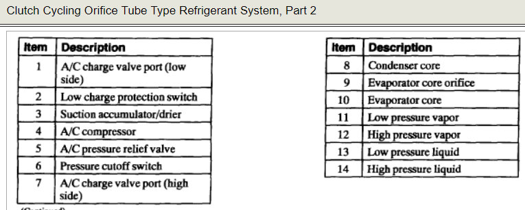

Sometimes the Low-Side port can be hard to locate.The low side are the larger of the two lines for the A/C system. Please see the attached diagrams and video to help you locate the service port. I have also attached a guide to help you charge the A/C once you locate the correct service port.

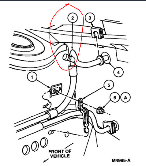

i apoligize for not getting back to you sooner. thats not the port. thats for evap testing. yours will be a black cap. the adapter is on the fatter of the 2 ac pipes.

I've added a picture below of the low side service port on your car and circled in red. Hope this helps and thanks for using 2CarPros.
