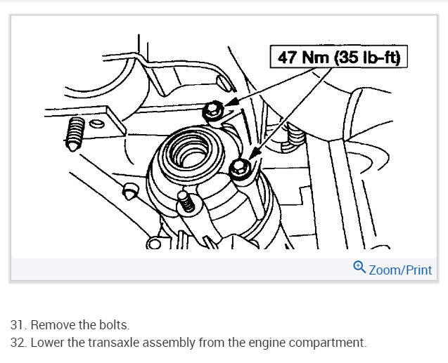

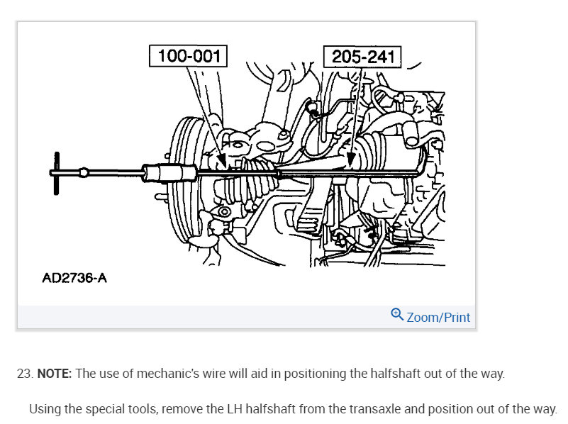

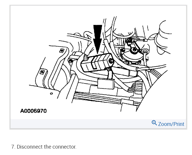

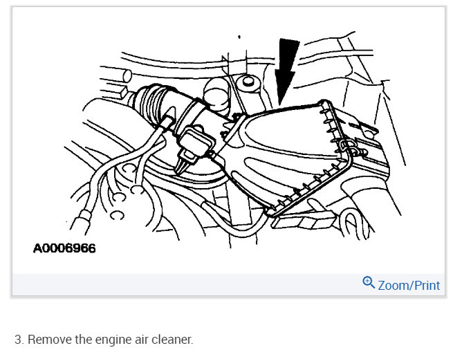

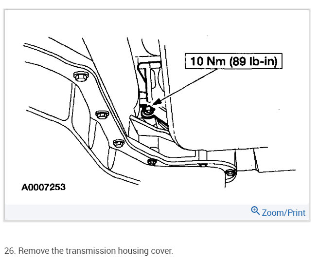

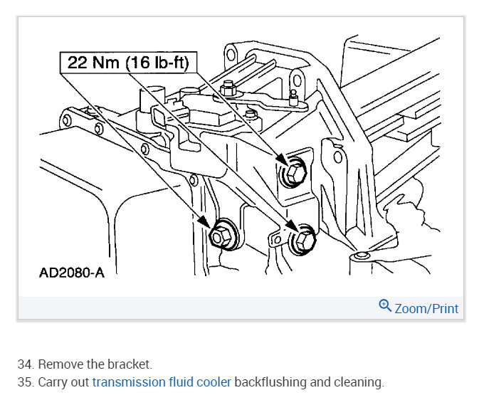

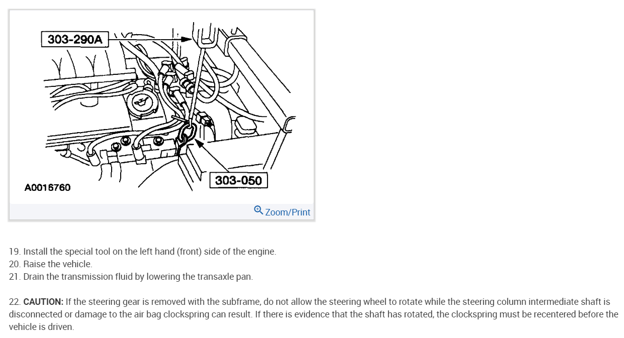

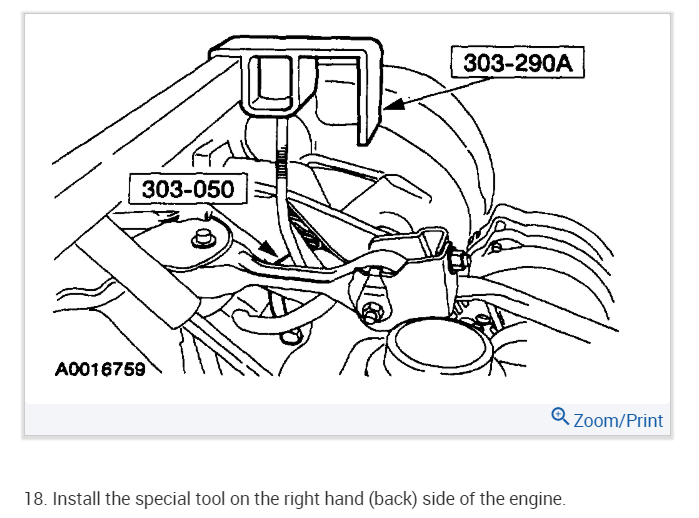

hello I am trying to remove the transmission from, a 2003 ford taurus and my instructions say to remove the sub frame but there are no instructions on how. Can you tell me how.
Jun 7, 2009 at 11:05 AM
JGAROFALO
  • 489 POSTS

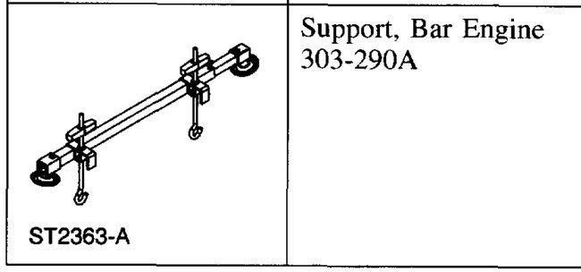

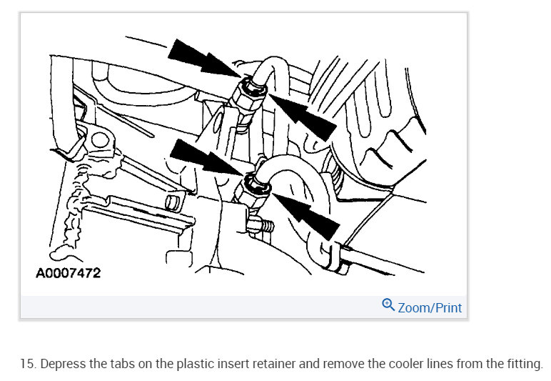

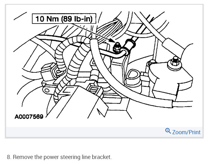

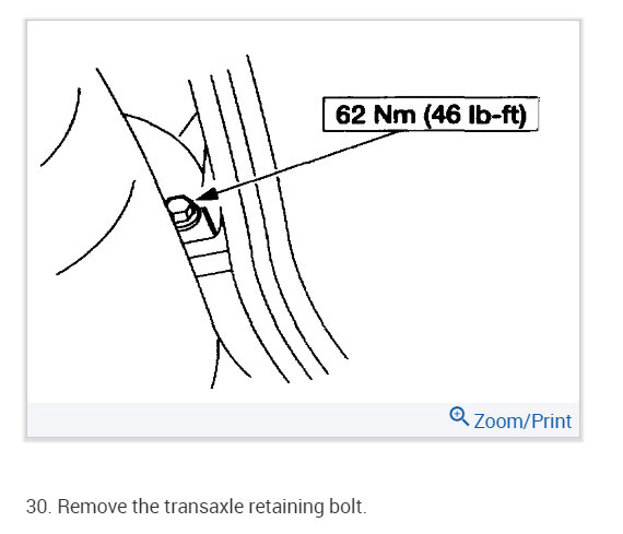

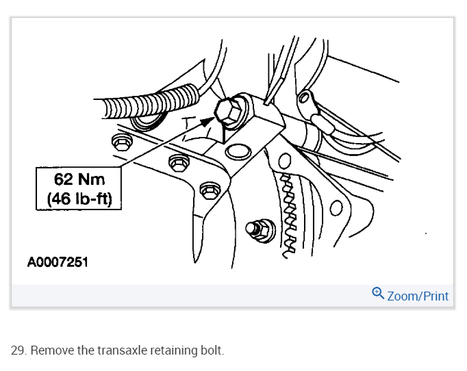

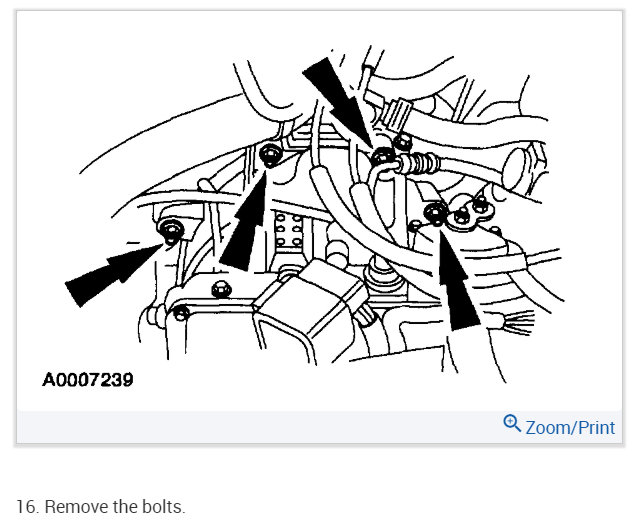

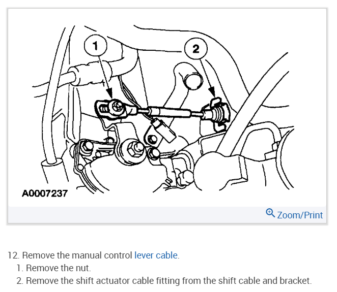

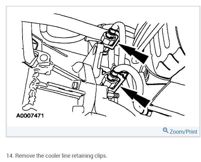

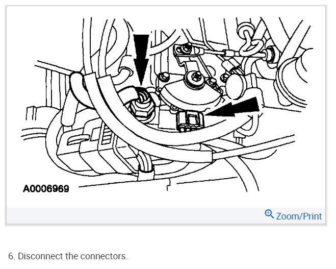

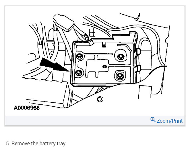

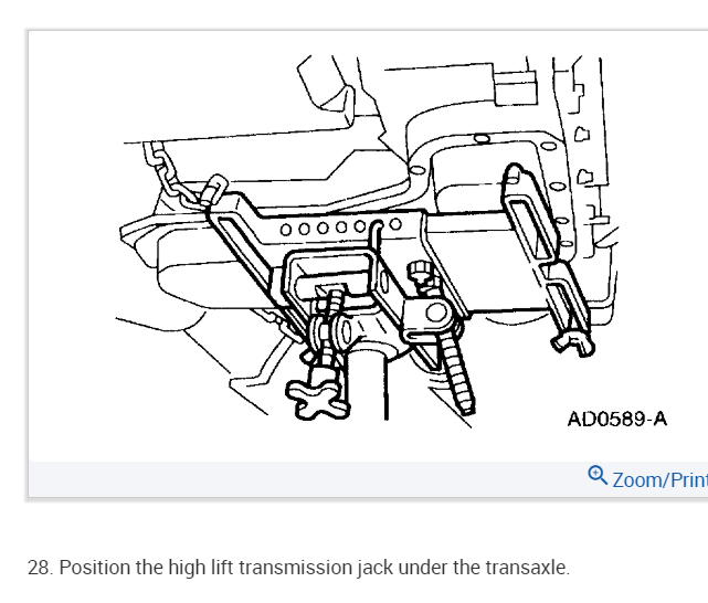

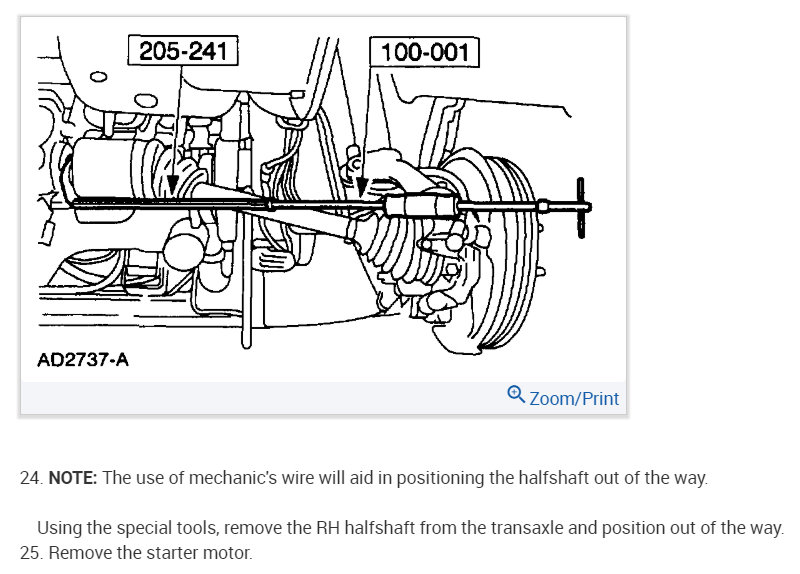

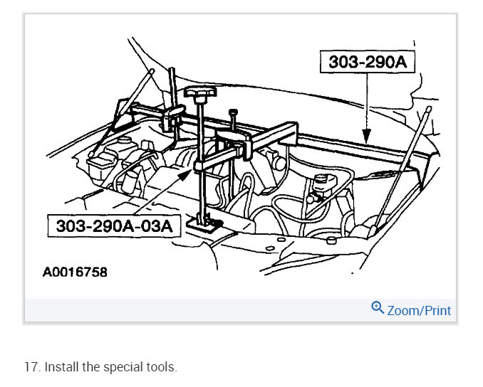

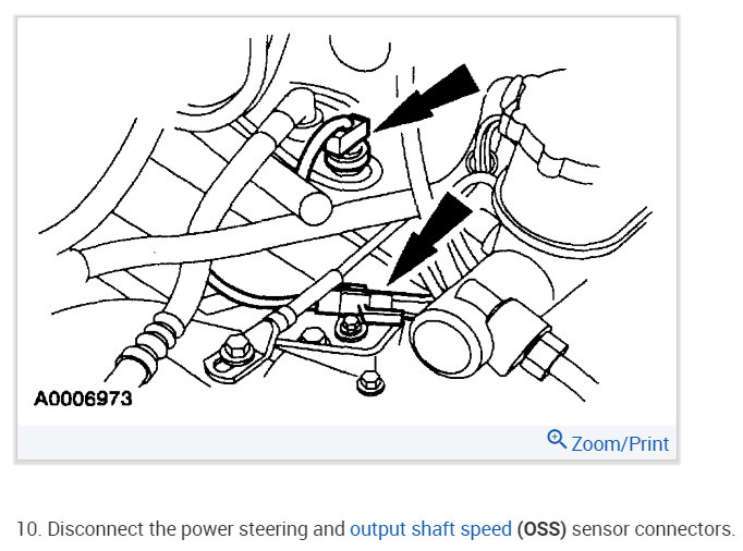

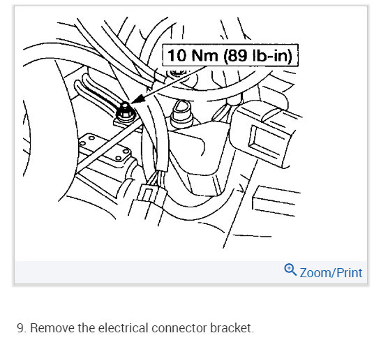

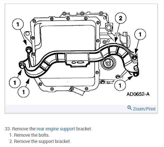

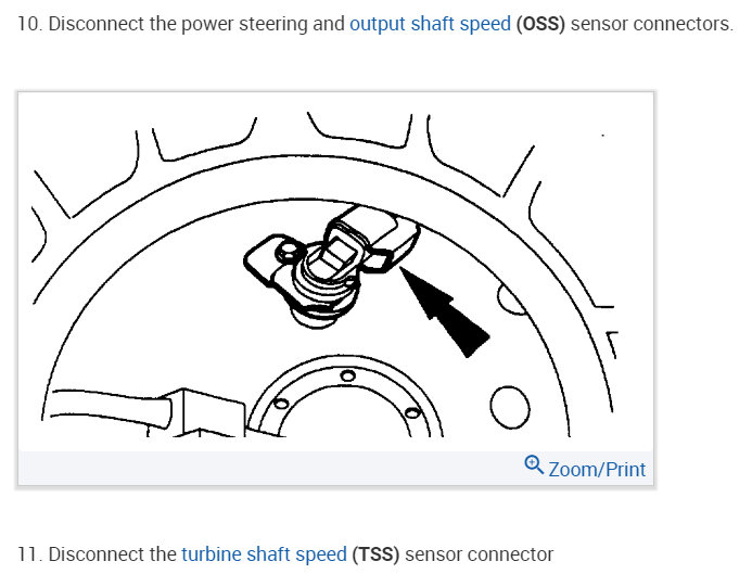

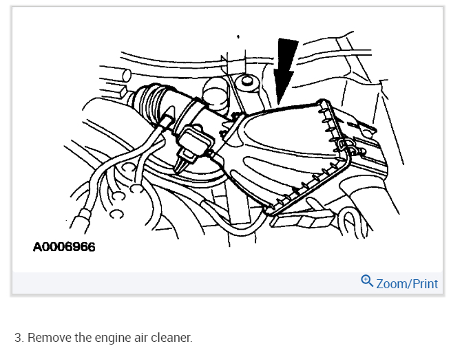

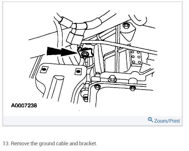

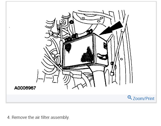

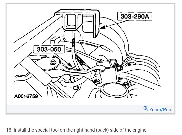

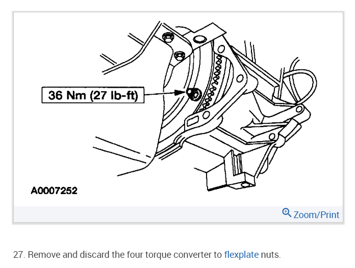

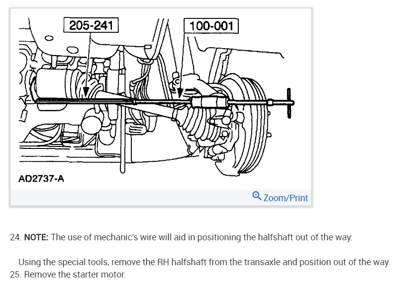

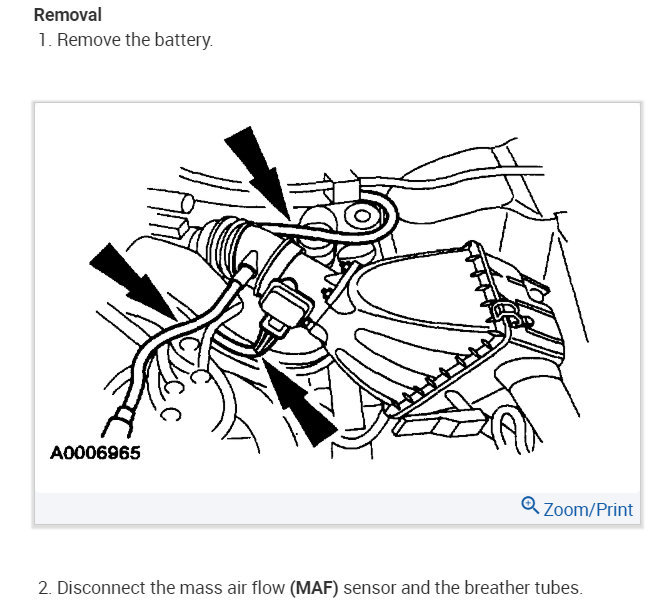

Here is a video that shows a front wheel drive transmission getting pulled out so you can see what you are in for and the diagrams below to show you what it is like for your car.
https://youtu.be/6N6b5F2ChyE
To remove the subframe, you must:

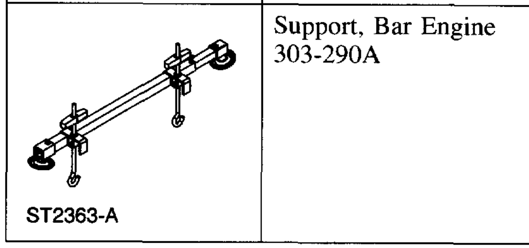

1) support the engine from above. This is important, as the entire powertrain is supported only by the subframe.
2) Remove the motor mount bolts from the studs. Remove the bolts that hold the side support for the transmission.
3) seperate the lower ball joints from the steering knuckles.
4) remove the steering rack mounting nuts from their studs.
5) Remove the catalytic converter and exhaust pipe assembly.
6) Disconnect the stabilizer bar links from the front struts.
7) remove any clips or brackets from the subframe that attach oil lines (power steering lines, trans cooler lines, etc.)
8) remove the bolts that hold the subframe to the body. When you remove these bolts, the subframe will tend to fall. Best to support it with blocks or stands.
Cheers
