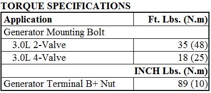

What are the torque specs for the alternator on a VIN U 6-cyl engine

https://images.2carpros.com/forum/automotive_pictures/55316_03taurusalt_1.jpg
VIN U is 3.0L 2V
