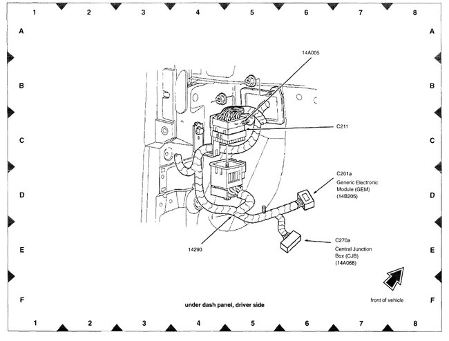

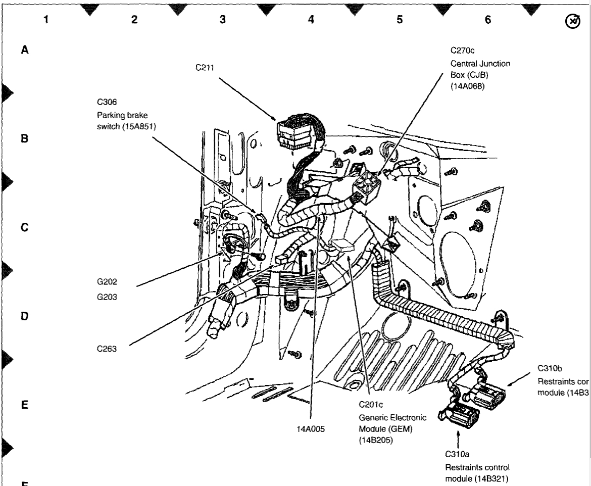

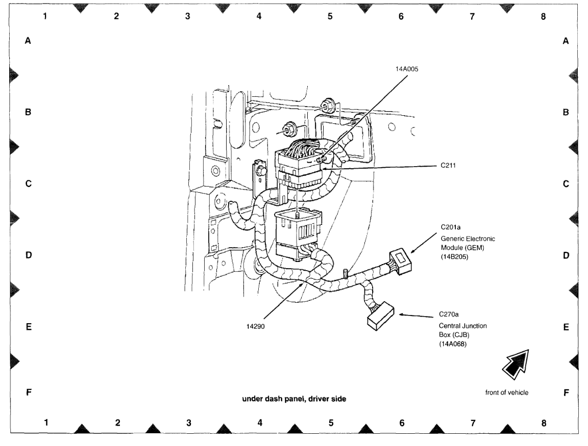

Trying to find the GEM control module...can you tell me where to find the box?
Sep 28, 2009 at 10:40 AM
BMRFIXIT
  • 19,053 POSTS
This all what this car have for modules and its locations
Generic Electronic Module (GEM) Under left side of dash.
Powertrain Control Module (PCM) Right rear corner of engine compartment, mounted in firewall.
Here is a diagram so you can see what I am taking about
